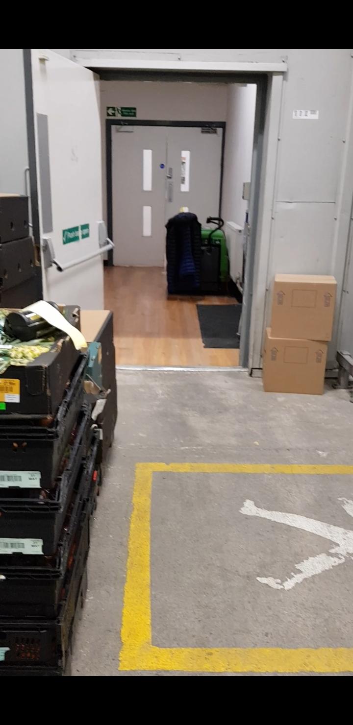

Guest Jake Posted June 17, 2019 Report Posted June 17, 2019 We had four fire exit doors, two external and two internal. One of the internal fire exit doors has been taken off the alarm system and is considered a fire door. My query is, does it require a self closing mechanism, as I know fire doors have to be kept shut. At the moment this "fire door" doesnt shut by itself. Thanks Jake Quote
AnthonyB Posted June 18, 2019 Report Posted June 18, 2019 If it is a door to the outside it doesn't automatically need one, if it's between two internal areas it is more likely to need one - generally of part of a protected route or a compartment wall Quote
Guest Jake Posted June 20, 2019 Report Posted June 20, 2019 On 18/06/2019 at 22:52, AnthonyB said: If it is a door to the outside it doesn't automatically need one, if it's between two internal areas it is more likely to need one - generally of part of a protected route or a compartment wall Its an internal one yeah, it still has a push bar. Do you think it should be replaced with a proper fire door? Quote
AnthonyB Posted June 20, 2019 Report Posted June 20, 2019 Without seeing the layout of the building I can't be certain Quote
Guest Jake Posted June 20, 2019 Report Posted June 20, 2019 1 hour ago, AnthonyB said: Without seeing the layout of the building I can't be certain Here's the fire route Quote
AnthonyB Posted June 23, 2019 Report Posted June 23, 2019 If those are compartment walls (as they could be) you would expect a self closer. Quote
