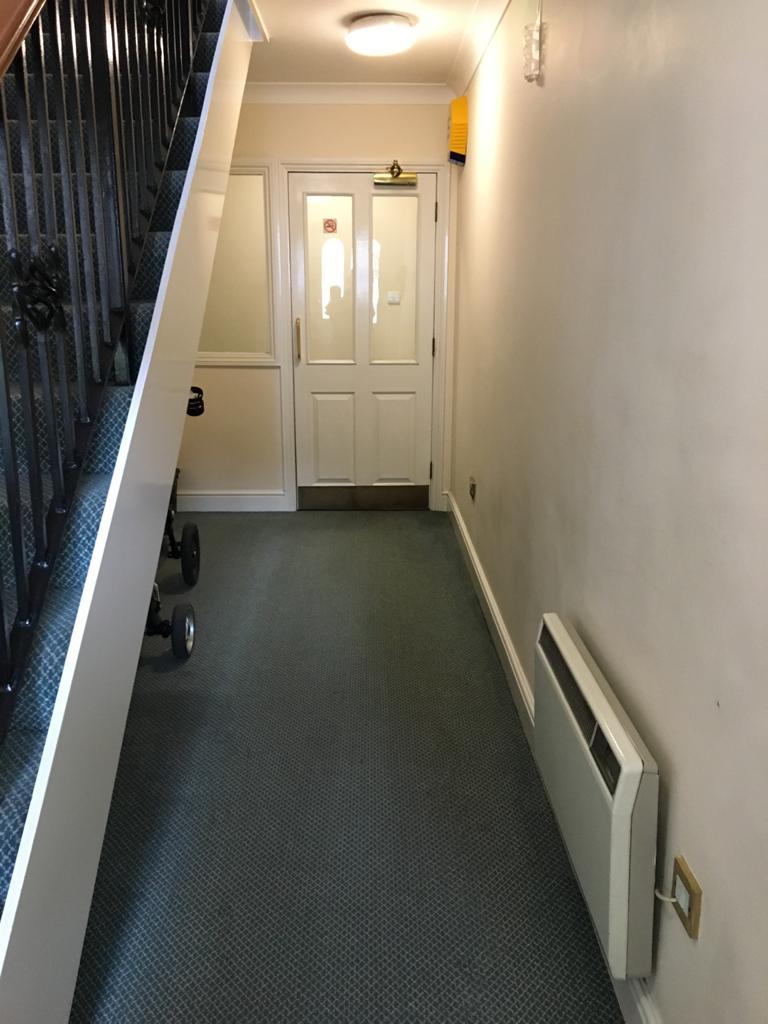

j03k30gh Posted June 4, 2020 Report Posted June 4, 2020 Good afternoon all, I came across this form on a google search following a notice from our property manger to remove a baby's push chair from beneath a stairwell. I would normally instantly comply with such a notice but the issue is that our apartment is on the first floor, there is a lift provided but this is at the top of a half flight of steps (I know, kind of pointless lift) also I would like to point out that the it is only the push chair frame of the push chair that is left beneath the stairwell as the seat and baby are carried up the stairs. The issue is returning to bring the frame up would result in the child being left alone upstairs. Also carrying the frame up the stairs is difficult for the mother of the child particularly when on her own. The building was purpose built (not a conversion) in the mid 90s and contains 5 no. flats, 2 on the GF, 2 on the 1st floor and 1 in the roof space on the 2nd floor. When entering the front door (not a level threshold) there is a straight flight of stairs (no half landing) to the left and a corridor straight ahead that runs along side the stairs extending to door which leads to the lift and front doors to the GF flats (picture attached). The frame of the push chair is normally stored beneath the stairs, this is not an enclosed space and the post boxes are also fixed to the wall beneath the stairs. I would imagine that the notice has been issued as the storage violates two things - first storage of materials (possibly combustible) in the fire route and the second a potential of blocking a fire route from the GF apartments. I would like to argue that firstly the frame is not combustible or has a low risk of combustion (rubber wheels?) and second that if there is a way of ensuring the push chair does not encroach into the escape route then there is little risk. I believe this can be done by installing a low level rail/barrier beneath the stairs dividing the area used for storage from the escape route? Is there any argument that can be made to update the risk assessment thus allowing the push chair to be stored beneath the stairs? Or any documents or route that could be used to argue this? I look forward to your response. Quote
AnthonyB Posted June 4, 2020 Report Posted June 4, 2020 Your agent is applying the 'zero tolerance' approach detailed in Government fire safety guidance as it is the easiest to implement and leaves no ambiguity as to what can be placed in the common areas. However the guidance does offer an alternative which is ‘managed use’. This approach allows strictly defined use of common parts and limits the items allowed, to control fire load and ease of ignition. It includes strict conditions on where such items can be kept. For example, a ‘managed use’ policy might permit residents to: • place pot plants and door mats outside their front doors • have framed pictures and notice boards on walls • store bicycles, prams and mobility scooters in places that are out of the way and not likely to cause obstruction. It's not popular with agents as it requires a lot more hands on management and a bigger liability risk, but I have assessed premises where it has been effective due to the residents being proactive in monitoring compliance themselves. Quote

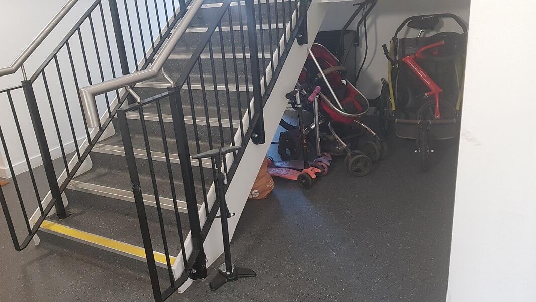

Bogdan Posted August 11, 2020 Report Posted August 11, 2020 Hello, I live in a 2 storey building with 9 shared ownership flats the landlord being Ealing Council. On the ground floor there is a space under the stairs which some of the owners/tenants use as a storage space for pushchairs and bicycles. we recently received a notice that we need to clear the space as it represents a fire hazard. As it stands, the stairs are built from concrete with metal railings, the fire escape route is clearly identified on the main corridor with two exit points from the building, there is no access from any flat going directly underneath the stairs so we are not obstructing anyone. Also, there are no sources of ignition which could cause a fire. Are we really breaking the regulations here? Thank you all for your contribution Quote
AnthonyB Posted August 17, 2020 Report Posted August 17, 2020 Yes, if the council is using the zero tolerance approach to these areas instead of managed use. The whole point of the areas being concrete and sterile is to prevent a fire starting in the common areas as the design of flats and the stay put policy is these areas are sterile. In the past serious fires have occurred and firefighters hampered by items in common parts, often as a result of arson. Tyres and seats burn, plastic melts and burns and whilst not immediately ignitable these items all include materials which will burn and produce thick black toxic smoke if exposed to a pilot fire using accelerant. There is scope for use of common areas for certain storage and items, but it requires ongoing management, regular inspections and 100% buy in and compliance from all residents and so most landlords take the easier option of zero tolerance. Quote
