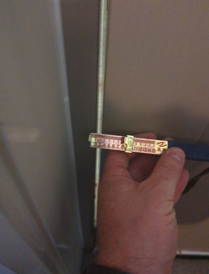

Guest Damian Smith Posted April 15 Report Posted April 15 Hi, I am looking at some steel flat fire doors in a high rise that have excessive perimeter gaps. I don't have the manufacturer's original specification. How can the gaps be reduced? Is the only option replacement? Quote
Neil Ashdown MAFDI Posted April 16 Report Posted April 16 Contact the Door & Hardware Federation for advice https://www.dhfonline.org.uk/ Quote
