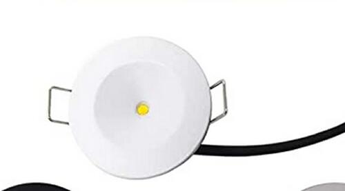

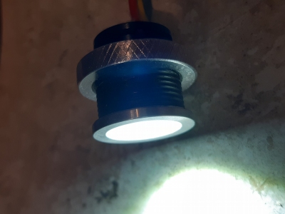

green-foam Posted September 3, 2020 Report Posted September 3, 2020 I would assume you have a single LED emergency light, normally they are green, but in a power failure they change to white. (See example images) If it is showing white that means the unit has no mains, or it has failed, I would check that it has mains first. Below are two images of the same light. Yes it is one LED it has been developed for sole use as an emergency light. When the unit has mains it lights up as a not bright green, in a mains failure it changes to a bright cool white and like other emergency lights, it will last for 3 hours. They are small and unobtrusive and can directly replace "down lights" Quote

green-foam Posted January 16, 2021 Report Posted January 16, 2021 For clarification purposes. Below are two pictures of the same light. (Not shown is the power-supply and battery) The light has a diameter of only 19 mm. It is two LED's in the same package. It is usually mounted in the ceiling, so all that is seen is the light itself. When "normal" the LED shows a "dim" Green light (As shown below) When the mains fails it shows a bright white light (As shown below) which lasts for a minimum of 3 hours Quote
