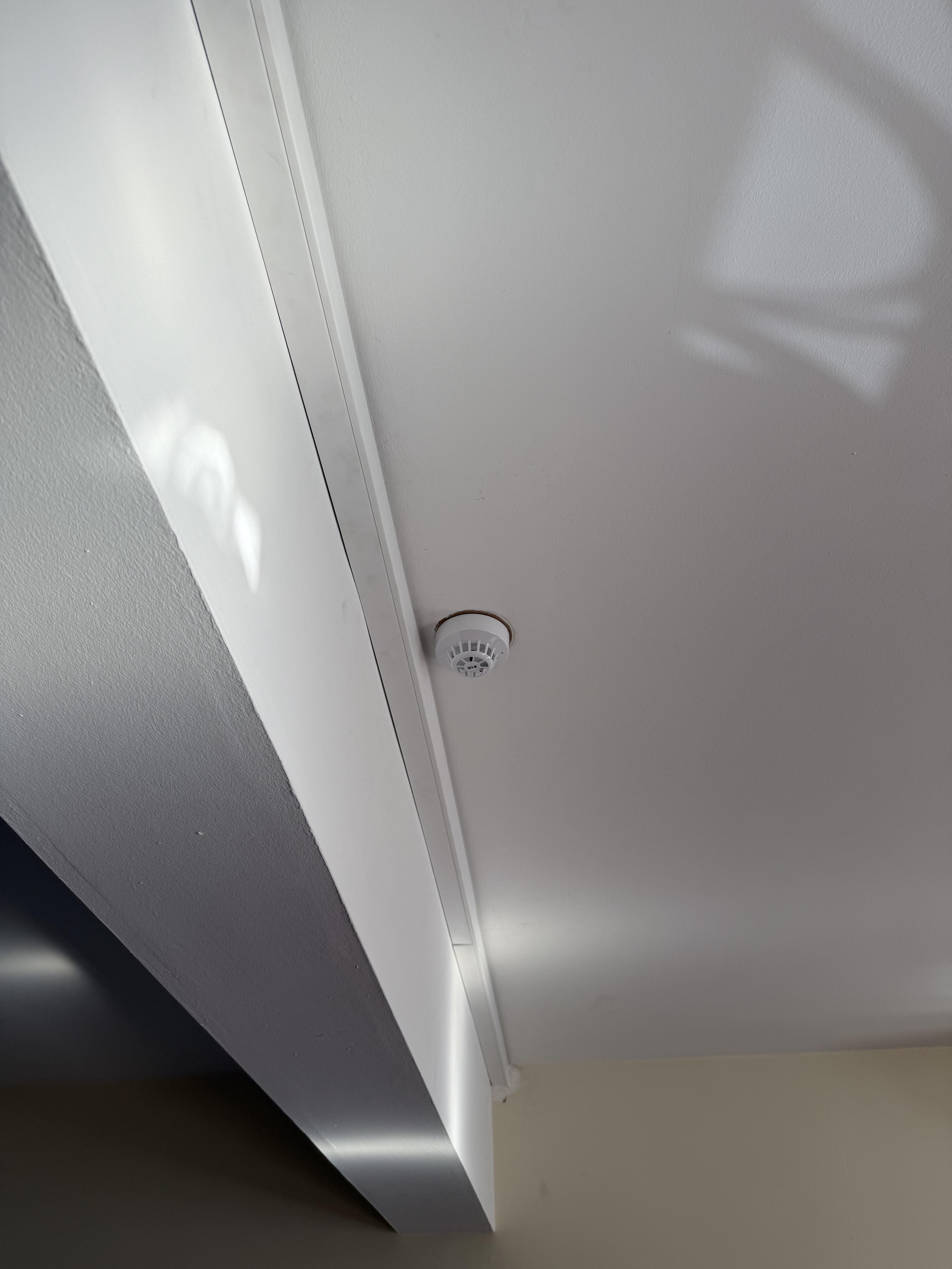

Good Morning,
Wondering if anyone is able to help/give advice - we have had a well known fire alarm company install devices and service our conventional fire alarm system, and passed it with a certificate at 100% compliance. (This has been the case for the past 7 Years)
I have noted that;
- MCP's are not installed correctly to the correct boxes
- Heat detectors installed throughout the premise (despite FRA saying only in kitchen areas)
- Detectors sited in wrong positions (e.g. Next to beams, Air Con Units etc)
- System devices wired to panel with Twin Earth cable rather then Fire Cable
- Mixed sounders on the system
Some of the above were also noted on the Fire Risk Assessment by the same company.
Upon their last inspection they stated they tested all 6 MCP's, 11 Detectors and 11 Sounders - Where no alarm was activated to do a sound check, and upon review of CCTV not all MCPS and Detector Heads were tested as stated on the inspection certificate.
I am currently composing a letter to the company with my concerns, and the quality of the service. (Failure of Contract Agreement) and Safety Concerns etc. Does anyone have any legislation I can relate back to?
The premises is a Hospitality Venue (Pub) with living accommodation above for the Pub Manager.
I will upload photos separate of some of the devices and issues.
Any help would be appreciated

Detector location is off too. Easiest thing would be to sack them unless a large sum of money is involved. You'd need an expert witness report cross referencing BS5839-1 (including old editions to show how long things didn't meet the standard, if ever), the FRA and Articles 5(3) & (4), 8, 13, 17 of the Fire Safety Order.
