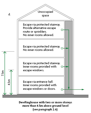

We are being told that due to the property having four floors we have to have a sprinkler system or an alternative escape route other than the stairs for the 4th floor.  Have you come across this situation?  The building control person is telling us that this is due to section 2.5b, diagram 2.1, image d.
Does this section only apply to dwelling houses, which consist of 2 or more residences as opposed to a SINGLE FAMILY dwelling house?

According to the definitions in Approved Document B, a "dwelling" is a single residential unit for a single person, single family, or up to 6 non-family persons living together, while a "dwellinghouse" is specifically where the entire premises is a single "dwelling". If there were flats, then neither the individual flats nor the overall building would be considered a "dwellinghouse".
That advice does seem to be in-line with the guidance in Approved Document B; though while the number of storeys is important, so is their height above ground level. The diagram in question shows a 4-storey property (excluding loft if unoccupied) with two storeys beginning within 4.5m of ground level, and the fourth storey beginning above 7.5m:
  • The third storey being above 4.5m means paragraph 2.5 applies, so you should have either a protected stairway (a) or an alternative escape route via a protected top storey (b).
  • Having multiple storeys above 4.5m means paragraph 2.6 also applies, so all storeys above 7.5m should have access to an alternative escape route (a) or a sprinkler system in accordance with BS 9251 (b).
There are more details and caveats to these paragraphs which I strongly advise you to familiarise yourself with. You can click on green words in the PDF to jump down to their definition. For example, a protected stairway is defined as: "A stair that leads to a final exit to a place of safety and that is adequately enclosed with fire resisting construction. Included in the definition is any exit passageway between the foot of the stair and the final exit."
Ah - four floors, that makes a difference, unfortunately they are correct.
