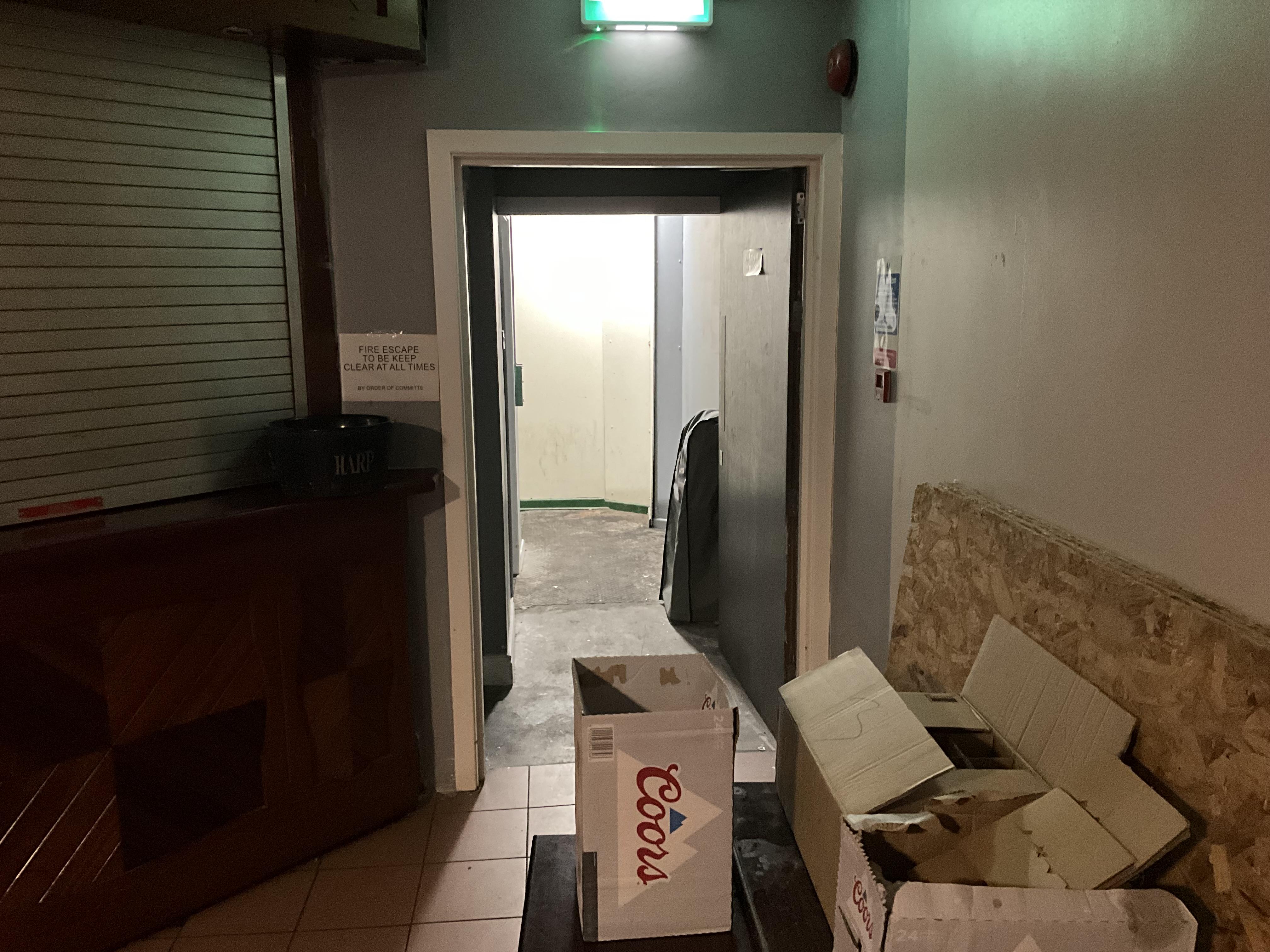

Lyledunn Posted October 10, 2024 Report Posted October 10, 2024 The door is required to be 1100mm but the evacuation chair in the short landing beyond restricts the width between walls to 880mm. The same crew that widened the door, fixed the evac chair in place! Quote
AnthonyB Posted October 10, 2024 Report Posted October 10, 2024 Doesn't look big enough for a refuge either! Quote
