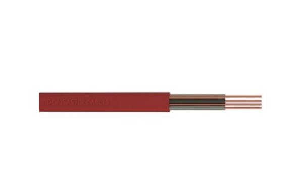

I'm getting more commissioning work , I use solo equipment. I'm doing HMOS and I've found two recently that have red PVC for the zones which unfortunately does not have any FR.

This red PVC cable, is it 3 core and earth that is used to power and interconnect the smoke alarms? If so, the question should be, are the smoke alarms suitable for the property. Red 3 core and earth is made by Doncaster cables to identify that the cable is not a 2 way switching cable (That is what grey 3 core and earth is used for) but it should only be used for interlinking smoke alarms.

Red PVC is often used to hide the fact to a casual observer that they have used non FR cable in order to reduce costs.
If the sounder circuits are PVC this is a critical non compliance and has to be rectified. You can't certify a post 2002 system as compliant with the standard either where the detection zones are non FR even if the sounders are FP.
If it is only the detection zones an agreed variation may be possible but the fire alarm designer, client, fire risk assessor & enforcement authority would need to agree it and the control panel would need to be set up to operate as 'Short Circuit = Fire' rather than the modern default of 'Short Circuit = Fault' to compensate for the non FR detection cabling so it's destruction by fire would result in an alarm rather than a fault.
