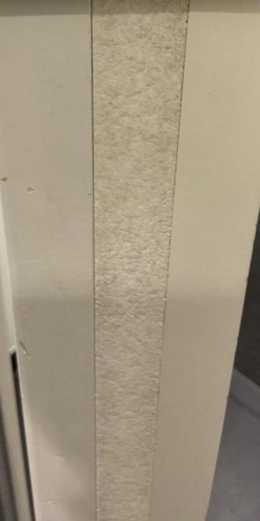

On an FD120s fire door is a white material strip on closing/hinge side of leaf. The seal is not enclosed in plastic. Would this be intumescent? There are intumescent seals (in pvc casing) on frame along with batwing seals. I was just wondering could this be some kind of acoustic material but why is it on show where it could get damaged.
A picture would be more use - could be for noise, sounds unlikely part of the fire protection - perhaps it was added after installation as the door slam was found to be too loud.

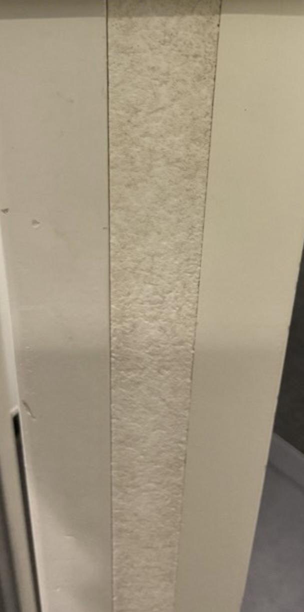

Please see attached photo of the seal on edge of leaf. The seals looked to of been doubled up.
This looks like an edge seal of intumescent material.  FD120 doors require a greater amount of intumescent edge sealing than lower rated fire doors.  Is there any mark, label or plug on the door enabling traceability to the door manufacturer?  If so it should be possible to answer your question by consulting them.
