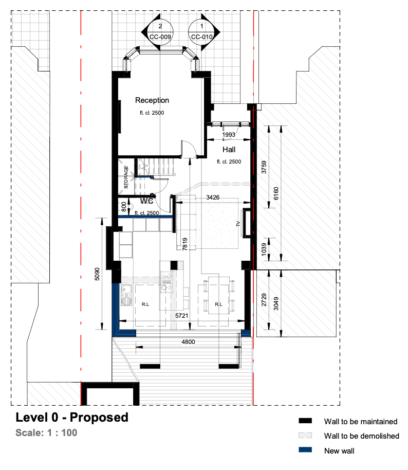

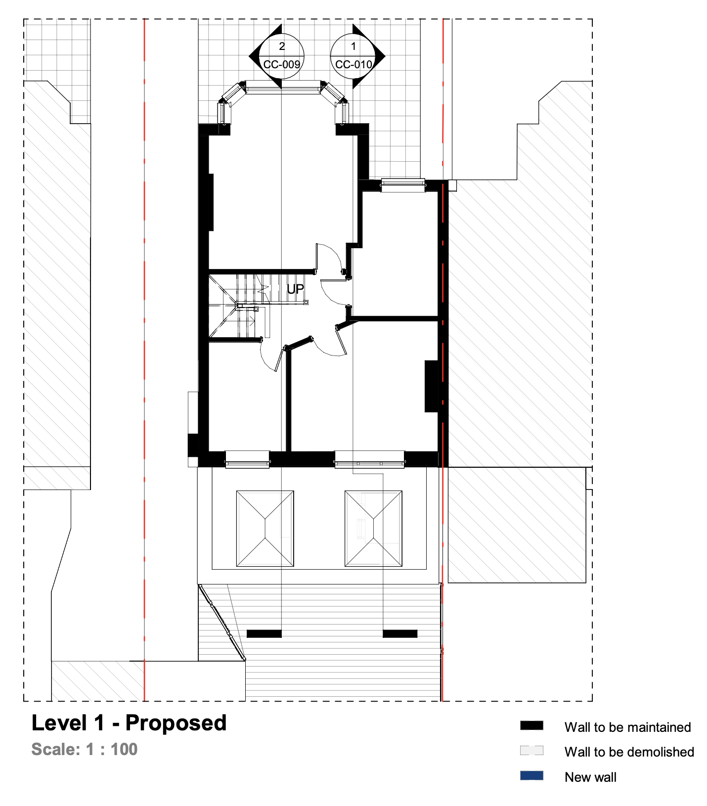

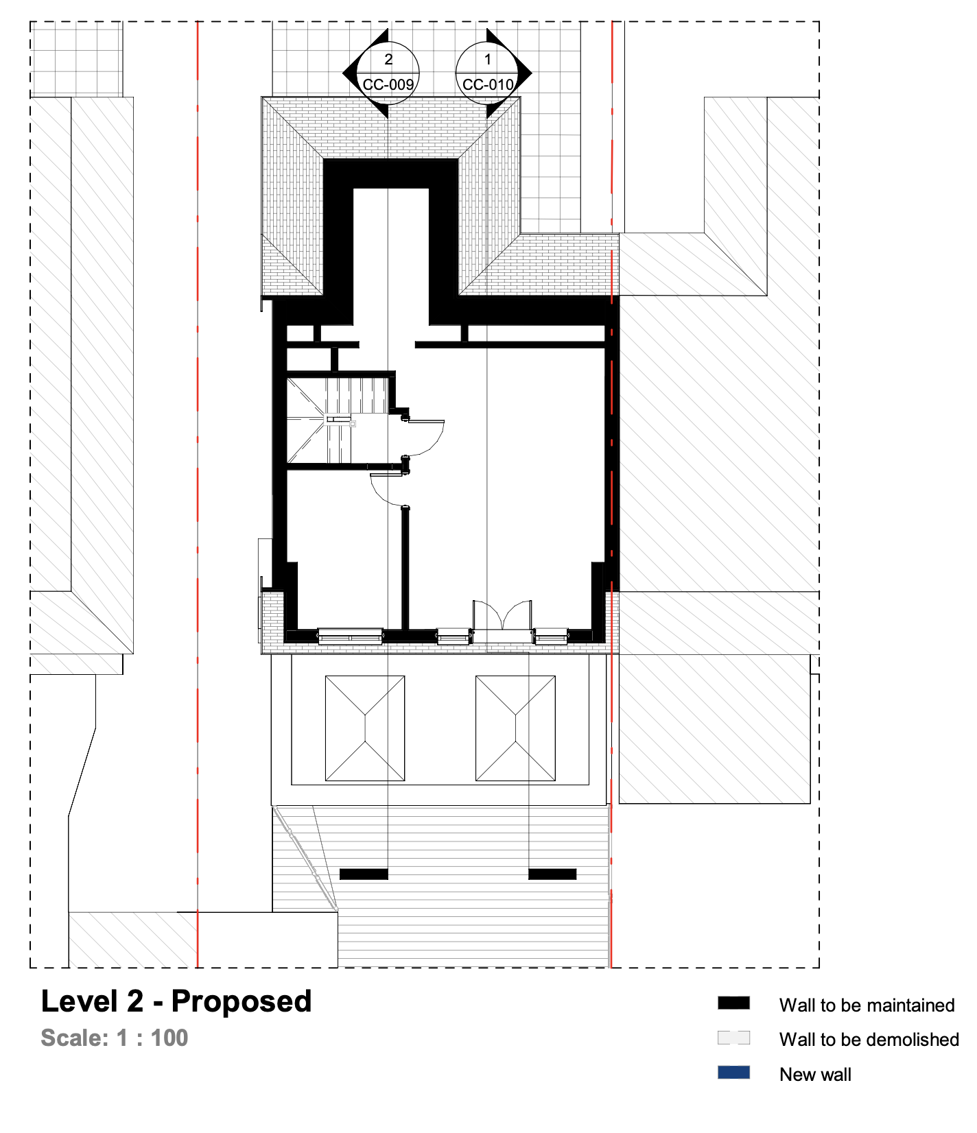

The house is a normal 1930's semi detached house. See attached images for the layout. We are only changing the ground floor.
We recently consulted with a fire safety engineer who prepared the following points for review by the council. These are the measures we have already planned:
(i) Installation of a single, unified automatic fire detection and alarm system (Type LD1 - minimum Grade D2) to BS 5839-6:2019+A1:2020 throughout the entire dwelling, with simultaneous evacuation of all floors when an alarm is triggered. This includes detection in all habitable rooms and circulation spaces, interlinked and mains-powered.
(ii) Installation of an automatic fire suppression system (e.g., a domestic sprinkler system to BS 9251:2021 or an equivalent proprietary mist system to BS 8458:2015) throughout the open-plan areas on the ground floor, including the kitchen, living, and dining areas.
(iii) Enclosure of the stairway on the first and second floors with 30-minute fire-resisting construction and FD30 doors (except in WCs), with no requirement for self-closers. The walls between bedrooms/habitable rooms and the landing/staircase inherently enclose the stairway.
(iv) Enclosure between the reception room and the open-plan areas on the ground floor, using 30-minute fire-resisting construction and an FD30 doorset—again, with no self-closer required.
(v) A window suitable for escape will be provided in the front bedroom on the first floor.
As you can see, we are already implementing an iMist system and other fire safety measures. However, building control is still not satisfied and has not approved the plan, even after this report from the fire engineer. Their main concern is that point C in the Part B regulations document is not being addressed.
This is why I am seeking your expertise. If we add a new wall to separate the kitchen on the ground floor, it will compromise the open-plan design, which is the core reason for our renovation. I am not trying to avoid any safety measures, as demonstrated by the comprehensive steps we are already taking to ensure the safety of our home.
Thank you again for your help.

Approved Document B is not a regulation, it is just one way of meeting the rather broad functional requirements of the Building Regulations and is not a mandatory document - you can use other methods:
"The fire safety requirements of the Building Regulations will probably be satisfied by following the relevant guidance in this approved document. However, approved documents provide guidance for some common building situations, and there may be alternative methods of complying with the Building Regulation requirements. If alternative methods are adopted, the overall level of safety should not be lower than the approved document provides. It is the responsibility of those undertaking the work to demonstrate compliance."
As what the fire engineer proposed is along the lines of what is often accepted I would suggest you request a determination:
https://www.gov.uk/guidance/building-regulations-determinations
