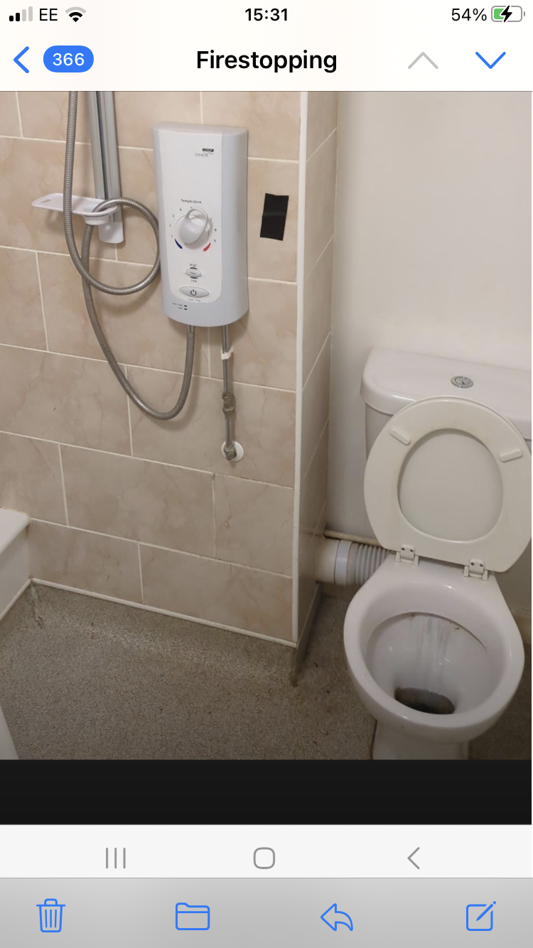

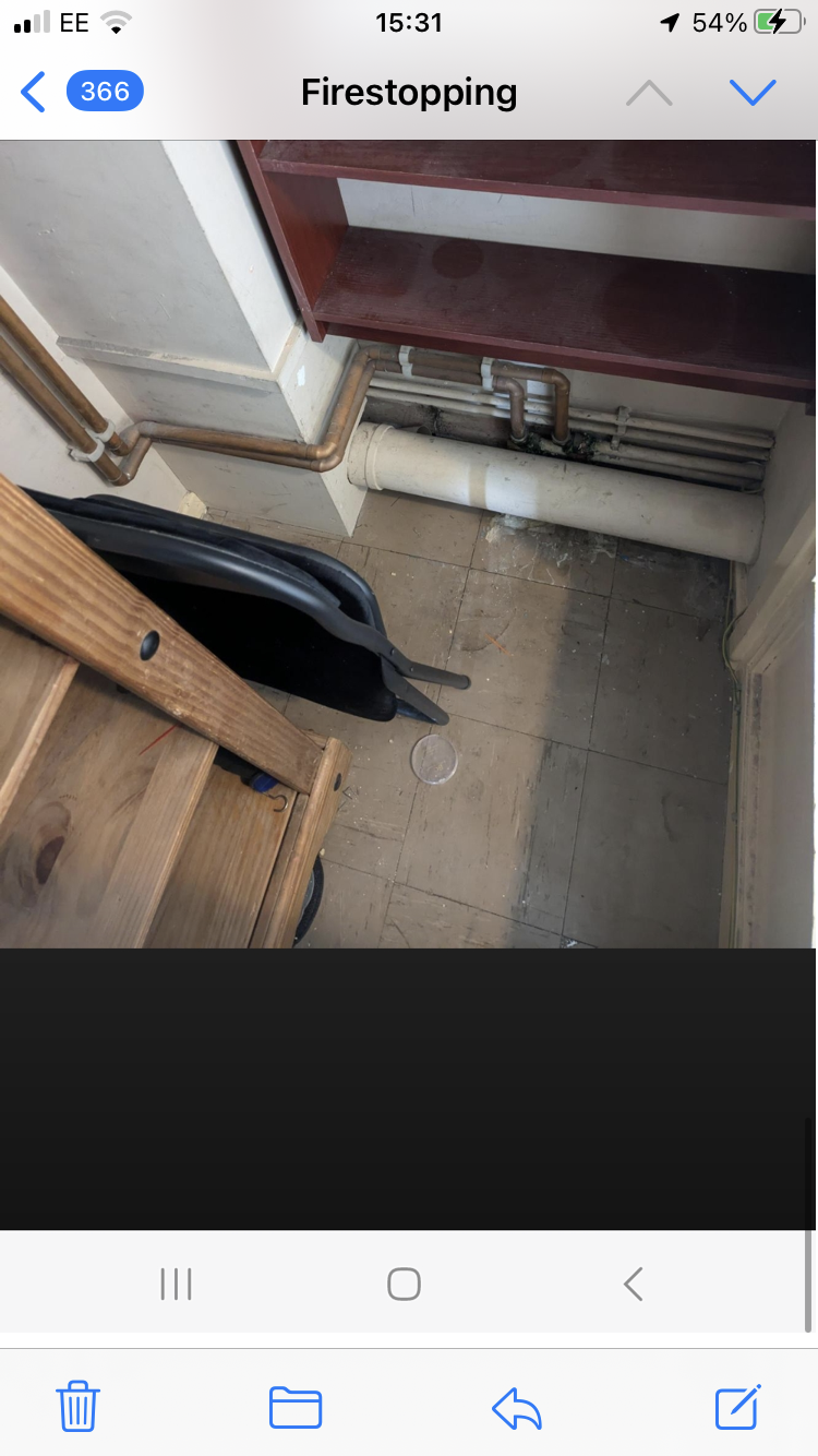

Hi all, After some advice on fire stopping within low rise residential flats. Company I work for ask that a mini FRA is carried out within a flat when it becomes empty and we’re asked to look at things like means of escape (travel distances, escape routes), conditions of entrance fire doors and compartmentation etc. As part of this, we look at the soil stacks and if fit a intumescent collar if not one present. We have recently came across the below situations where it is difficult and the only way of getting access to the stack is to remove tiles or get asbestos removed. Doing this causes loads of issues
My question is, do we legally have to fire stop within flats or is it just to the common areas only?
