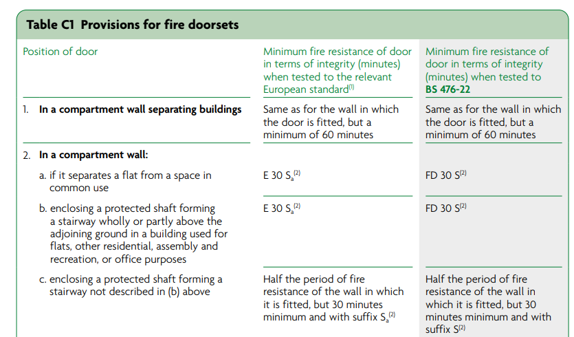

Neil Ashdown MAFDI Posted January 6 Report Posted January 6 https://assets.publishing.service.gov.uk/media/639ae7e98fa8f5069839c7d7/Approved_Document_B__fire_safety__volume_1_-_Dwellings__2019_edition_incorporating_2020_and_2022_amendments.pdf Appendix C Fire Door-sets. Table C1 2A on page 138 should help. Also this: https://www.gov.uk/government/publications/fire-safety-in-purpose-built-blocks-of-flats Quote

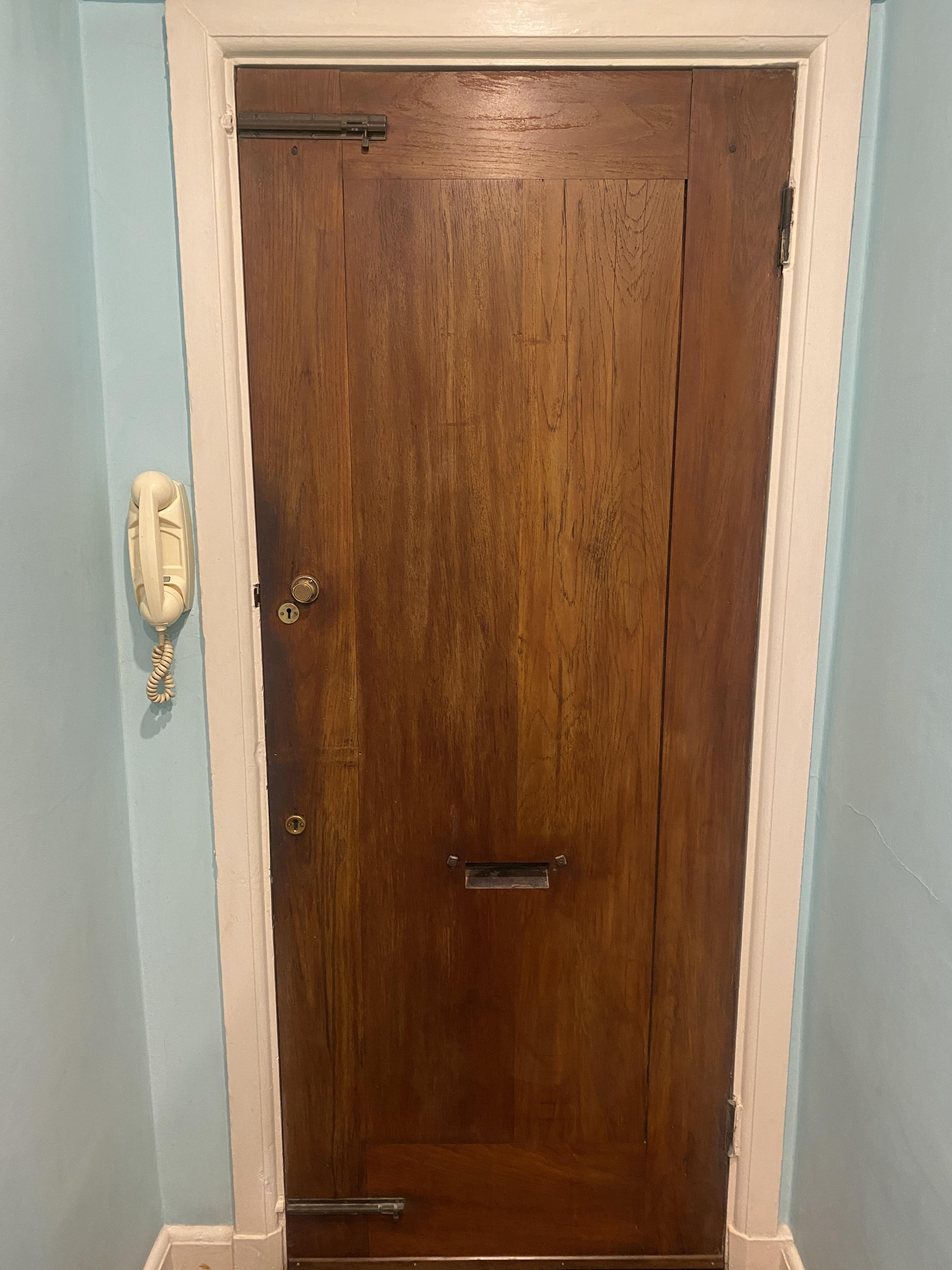

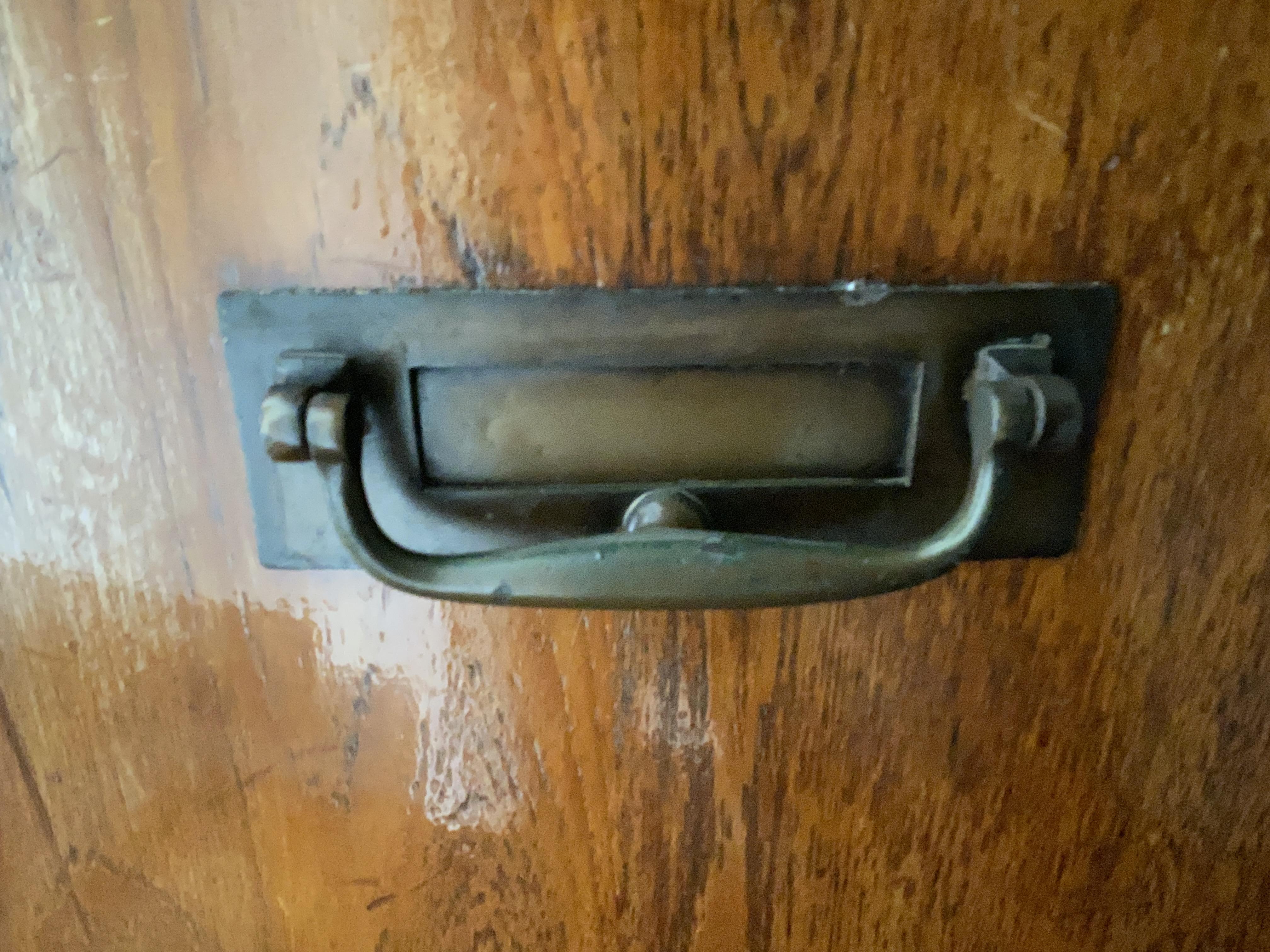

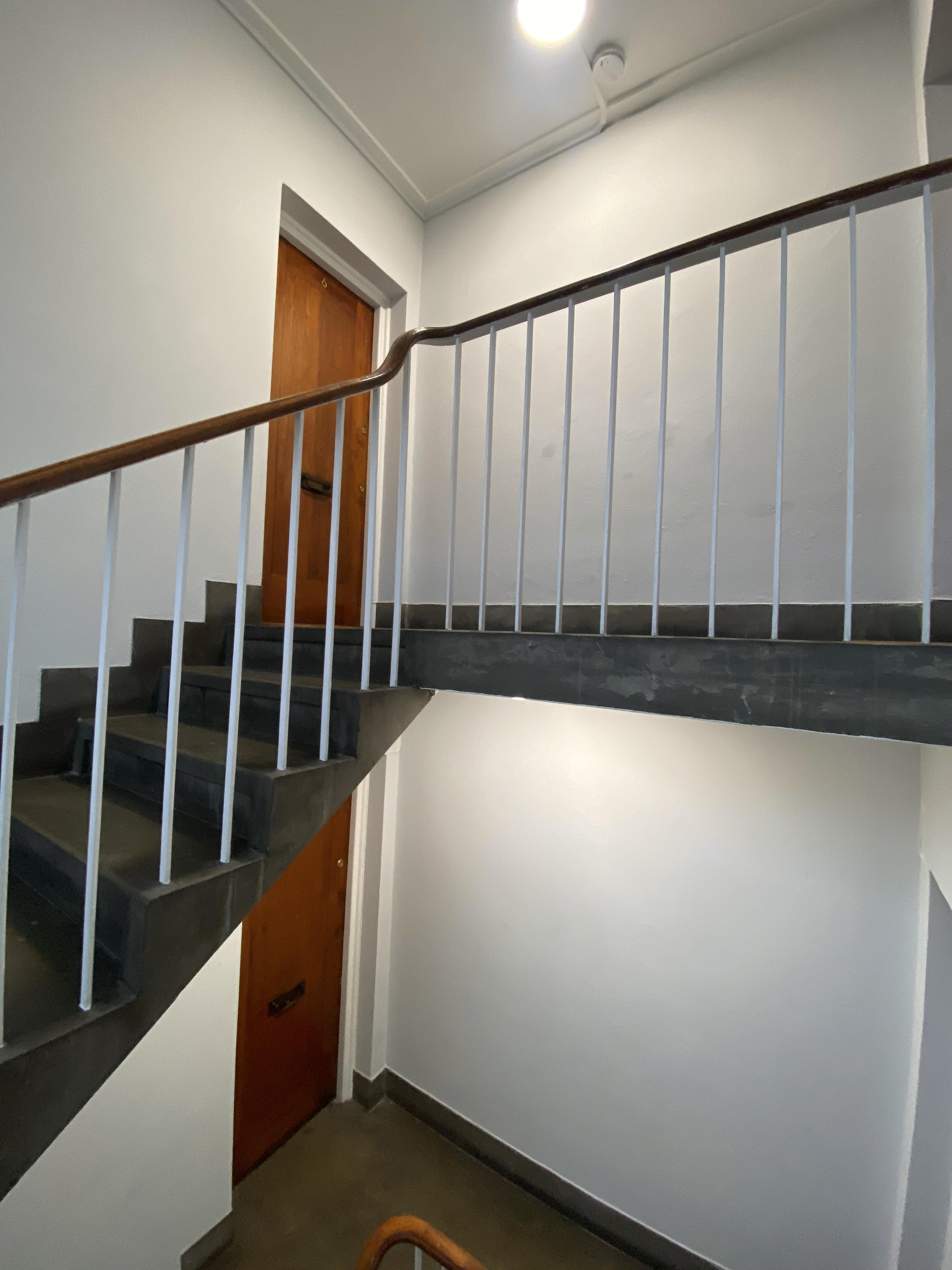

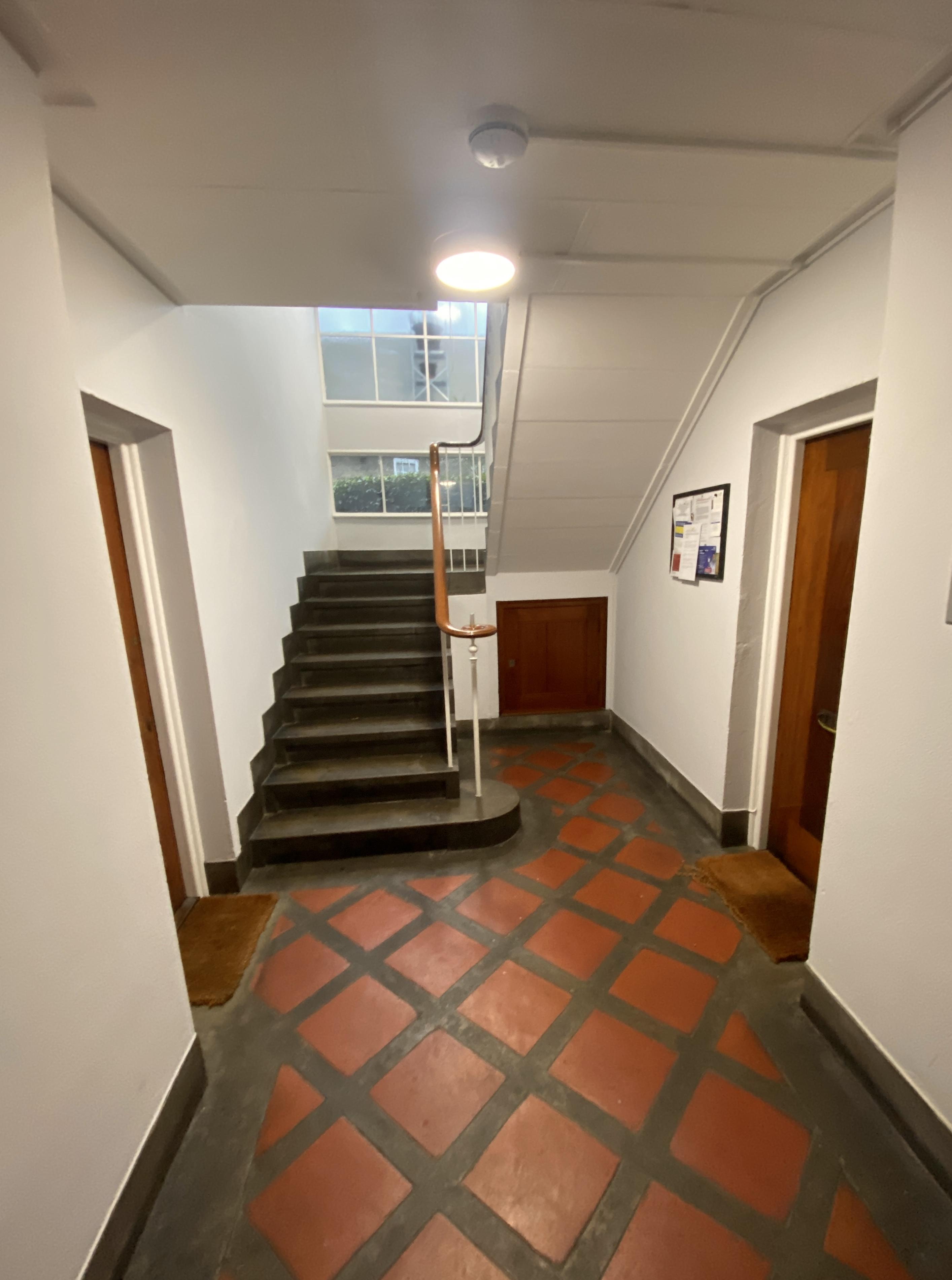

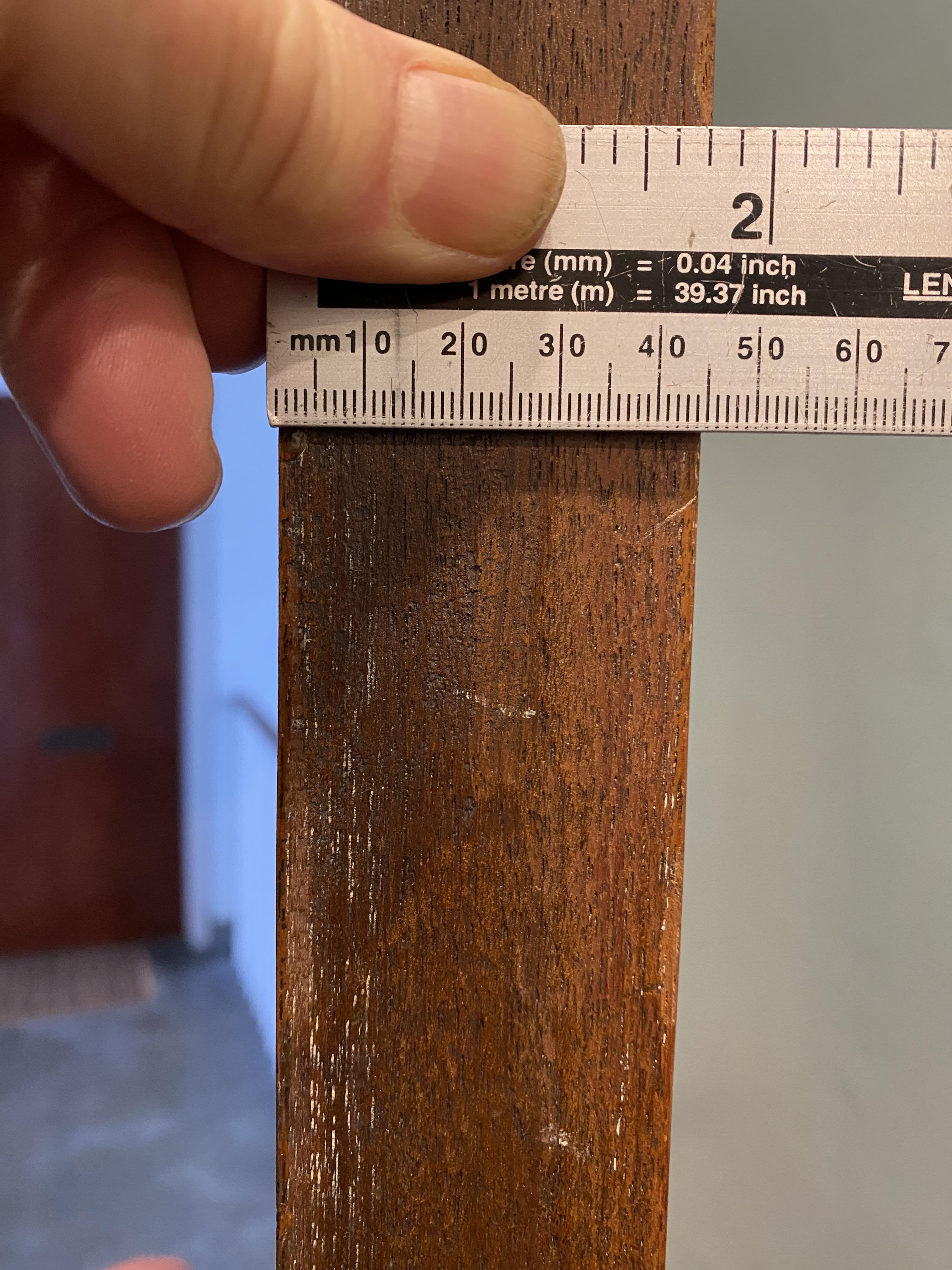

Guest NM3 Posted January 19 Report Posted January 19 Hi, this is interesting and helpful. In our case we live in a very solid 1930s building of local ‘architectural interest’. It’s a purpose-built concrete & brick block below 11 metres. And the stairs servicing the building are broad & clutter-free, with very little combustible material present. photo However, the assessment implied the doors to individual flats (very attractive & solid oak - photo) are probably not 30mins-fire resistant. This aspect was deemed a ‘Medium Risk’. We as residents very much wish to keep these doors as they are very much part of the architectural character/heritage of our building. What might we do to retain them ? Quote
Neil Ashdown MAFDI Posted January 20 Report Posted January 20 My advice would be to: Establish that the doors are solid core and in suitable condition, record your findings. Add suitable BSEN1154 compliant self-closing devices and make sure all doors self-close completely, reliably, smoothly and without risk of causing a 'trapping injury' - of fingers etc. Add intumescent fire seals and perimeter smoke seals. Make sure the door to frame gaps are between 2mm and 4mm (within reason). Replace the existing letter plate with a fire and smoke rated item and attend to the door threshold so that it will restrict the passage of smoke in a fire. UK Government advice about fire doors can be found at https://www.gov.uk/government/publications/fire-safety-england-regulations-2022-fire-door-guidance/fire-safety-england-regulations-2022-fire-door-guidance Quote
AnthonyB Posted January 20 Report Posted January 20 As Neil says! Did the FRA pick up the common area domestic smokes that the official guidance says aren't suitable and shouldn't be there as they confuse. Quote
Guest NM3 Posted January 22 Report Posted January 22 On 20/01/2025 at 19:52, AnthonyB said: As Neil says! Did the FRA pick up the common area domestic smokes that the official guidance says aren't suitable and shouldn't be there as they confuse. On 20/01/2025 at 13:45, Neil Ashdown MAFDI said: My advice would be to: Establish that the doors are solid core and in suitable condition, record your findings. Add suitable BSEN1154 compliant self-closing devices and make sure all doors self-close completely, reliably, smoothly and without risk of causing a 'trapping injury' - of fingers etc. Add intumescent fire seals and perimeter smoke seals. Make sure the door to frame gaps are between 2mm and 4mm (within reason). Replace the existing letter plate with a fire and smoke rated item and attend to the door threshold so that it will restrict the passage of smoke in a fire. UK Government advice about fire doors can be found at https://www.gov.uk/government/publications/fire-safety-england-regulations-2022-fire-door-guidance/fire-safety-england-regulations-2022-fire-door-guidance Hi Anthony No, they didn’t. Also consistently referred to them as Fire Alarms - So a bit confusing for us … Hi Neil We believe it might be sufficient to simply inform leaseholders of the findings & advice, as you’ve mentioned. And it will be for those individuals to decide whether to act on them. Also, as the doors are solid oak, and of 44+mm thick(pic) they could be regarded as sufficient for the 30mins. Apparently the minimum expected for purpose-built fire doors. And we could retain the period ‘30s letter plates by lining the interiors with intumescent material which would expand & seal in the event of extreme heat. Quote

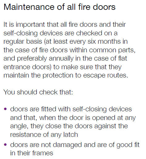

Hayfever Posted February 2 Report Posted February 2 On 30/08/2024 at 10:06, Mike North said: The height is irrelevant to fire door inspections, ALL fire doors should be inspected by a competent person a minimum of every six months and maintenance carried out on all defects. Fire Safety (England) Regulations 2022: fire door guidance (accessible) - GOV.UK (www.gov.uk) As for the different interpretations of the doors, it is a lot less work for the inspector to say that the door must be changed than listing the deficiencies and the required remedials to bring the door back to compliance. Unless there is a chain of custody, the history of the door is time consuming and difficult to track down, you pays your money and you takes your choice. I am confused by this as the Regs guidance states; routine checks of fire doors that the Responsible Person must ensure are carried out - these checks are only required in blocks of flats in which the top storey is more than 11m above ground level (typically, a building of more than four storeys) So I am reading this that the 6 monthly fire door checks are not required in a premises under 11m ????? Have I missed something???? Quote
Mike North Posted February 3 Report Posted February 3 BS 9999 Maintanence I.6.1 General In addition to the checks recommended in I.2, I.3, I.4 and I.5, the checks described in I.6.2 and I.6.3 should be undertaken once every six months. Arrangements should be made for six-monthly inspections and tests to be carried out by competent persons on the fire detection and fire alarm systems, the sprinkler systems, any extinguishing systems, the emergency and escape lighting systems and the firefighters lift, for any defects found to be logged and the necessary action taken, and for certificates of testing to be obtained. I.6.2 Fire doors All fire doors should be inspected every six months. In particular, it should be ensured that: a) heat-activated seals and smoke seals are undamaged; b) door leaves are not structurally damaged or excessively bowed or deformed; c) gaps between the door leaf and the frame are not so small as to be likely to bind, or so large as to prevent effective fire and smoke-sealing; d) hanging devices, securing devices, self-closing devices and automatic release mechanisms are operating correctly. Quote
Neil Ashdown MAFDI Posted February 3 Report Posted February 3 This refers to the checks to satisfy Regulation 10 of the Fire Safety (England) Regulations 2022 https://www.legislation.gov.uk/uksi/2022/547/regulation/10/made But if your property is not in-scope there is still a requirement to ensure your fire doors are suitable and in good condition, refer to Article 17 of the Fire Safety Order https://www.legislation.gov.uk/uksi/2005/1541/article/17 Quote
AnthonyB Posted February 3 Report Posted February 3 22 hours ago, Hayfever said: I am confused by this as the Regs guidance states; routine checks of fire doors that the Responsible Person must ensure are carried out - these checks are only required in blocks of flats in which the top storey is more than 11m above ground level (typically, a building of more than four storeys) So I am reading this that the 6 monthly fire door checks are not required in a premises under 11m ????? Have I missed something???? Falling into the trap of reading legislation in isolation. Even before the Fire Safety (England) Regulations there was a legal requirement under Article 17 for ALL premises subject to the Fire Safety Order to have a suitable system of maintenance for fire safety measures (including fire doors) however it didn't set intervals leaving that down to guidance & risk assessment. Due to there being a general failure in those managing flats to comply with this the Government introduced prescriptive requirements for the intervals that must be followed for blocks over 11m, but did not remove the existing requirements for other blocks, where guidance suggests 6 monthly communal door checks and annual flat front door checks (but not to 'best endeavours' like larger blocks.) Quote
