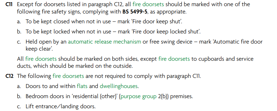

Hi Folk's , I was recently on a project (not inspecting) and I noticed the fire door keep shut/locked signs had been routed into the edge rather a sign fixed to the door face . How do you feel this applies document B and M ?
Advice would be much appreciated
THANKS
22 hours ago, Neil Ashdown MAFDI said:
Approved document B
So been a riser door fire door keep Locked fixed to the outside would be my choice. Why would it be inserted on the leaf edge ? Would you deem this a pass or fail ?
Approved document B doesn't cover this issue ?
