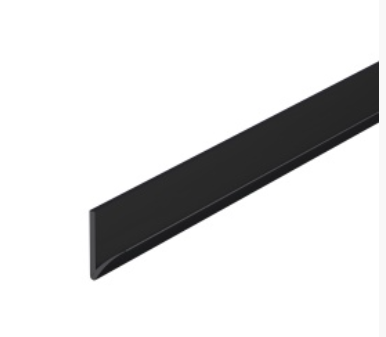

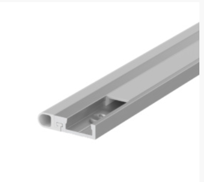

Neil Ashdown MAFDI Posted May 13 Report Share Posted May 13 (edited) Don't remove and replace the recessed intumescent strips unless they are damaged or unsuitable. The bat-wing seals if in good repair and fitted correctly should be sufficient as smoke seals. Replace them if necessary and ensure that the seal closes the gap between door frame stop and the face of the door leaf when closed. Examples of easy to fit seals below: Edited May 13 by Neil Ashdown MAFDI To add more info Quote Link to comment Share on other sites More sharing options...
Mike North Posted May 13 Report Share Posted May 13 As Neil states easy and cheap fix Batwing Seal | Lorient LAS1212 Smoke Seal | Fire Seals Direct Quote Link to comment Share on other sites More sharing options...
