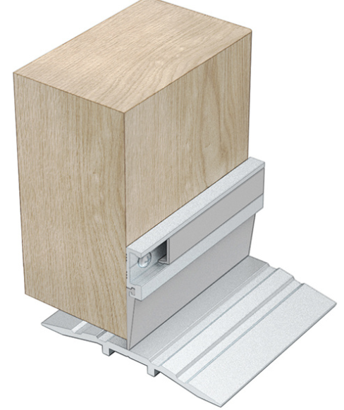

Guest Terry Posted May 1, 2024 Report Posted May 1, 2024 Hi, Can a brush draft excluder be used at the bottom of a fire door that has smoke control to reduce the spread of smoke? The gap is 3.5-5mm but I have been told it needs to be 3mm for smoke. The floor is uneven so a threshold strip may cause door leaf not to close. Quote
Mike North Posted May 1, 2024 Report Posted May 1, 2024 not unless it has been rated for such use Quote
Neil Ashdown MAFDI Posted May 1, 2024 Report Posted May 1, 2024 A surface mounted door bottom seal can be used. But make sure the door doesn't stick on the floor covering and fail to self-close. Quote
