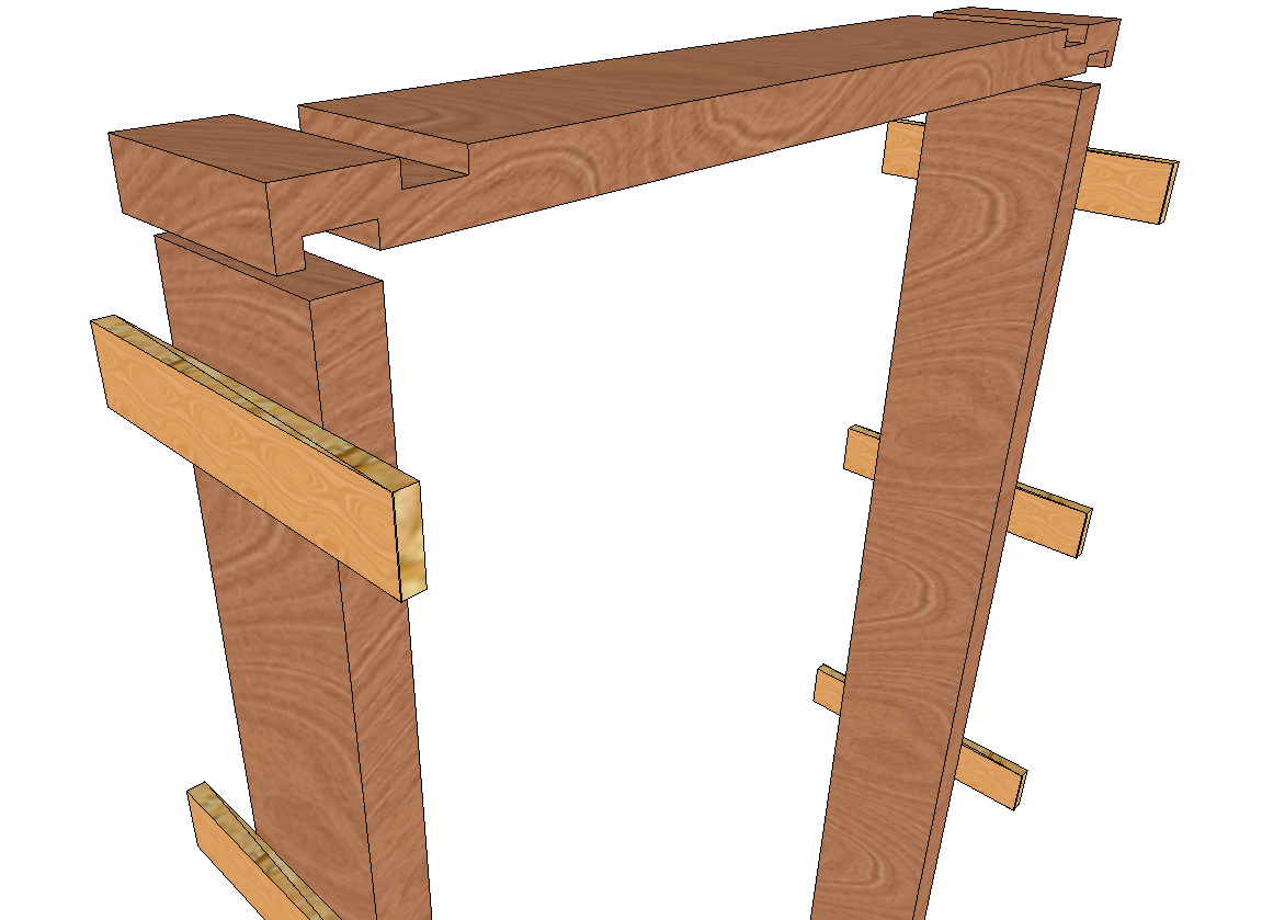

Yes it is. If you are using softwood (redwood or whitewood) for the door frame you can use the same materials for the packers / folding-wedges. But obviously, hardwood or hardwood plywood is more resistant to compression.
