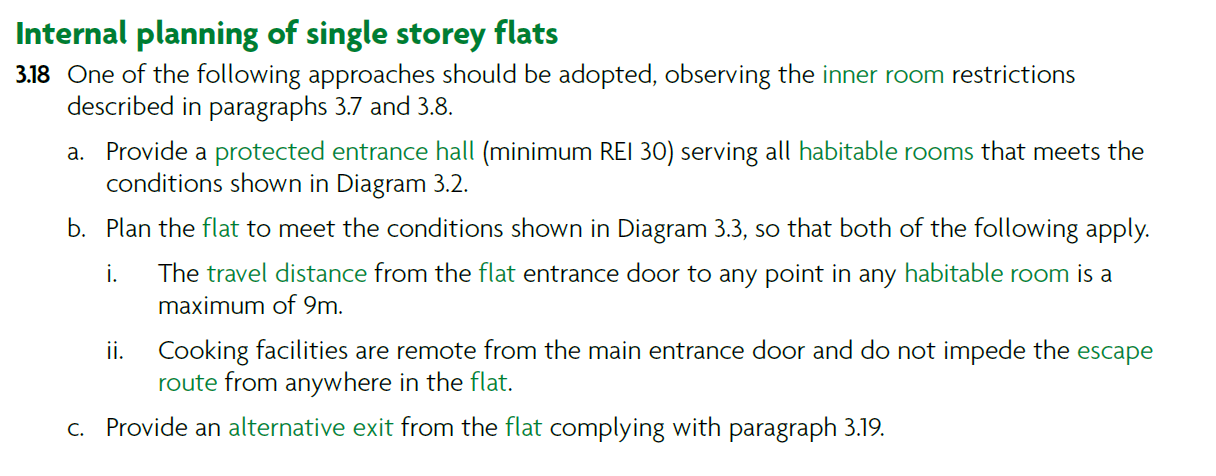

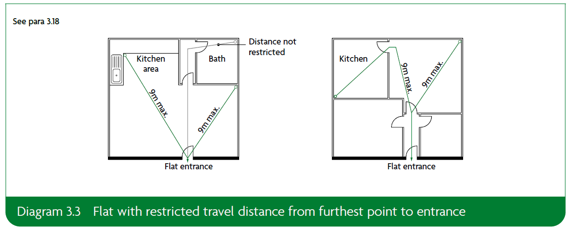

Obviously outside the scope of fire safety legislation being a private dwelling, but it appears it's a version of the below - although if only first floor and under 4.5m then means of escape windows would be adopted as a second escape.

Just out of interest, would the right hand side diagram have a fire door in the kitchen compartment?
