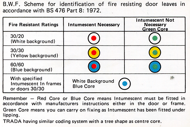

Hi, I'm new to this site and no means an expert in any way and belive that no matter what reply you get it will always lead back to the right advice from Mike in getting an qualified risk assessor to come out in person to tell you that you may need. That way your have peace on mind in knowing the right answer.

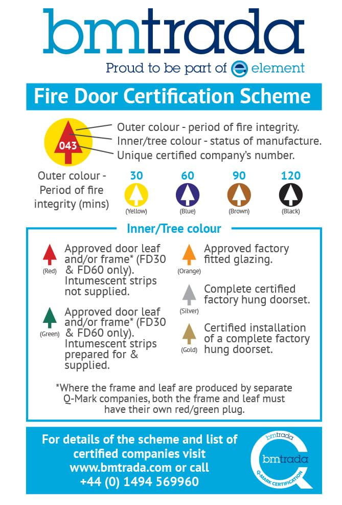

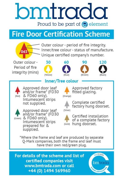

Having said that, I'd love to hear updates on this subject so we can learn more. Out of interest is there and small stamps with a arrow color on the old doors. Similar to the photo I've attached to the bottom
