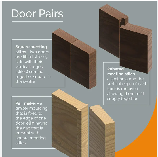

Neil Ashdown MAFDI Posted March 26, 2024 Report Posted March 26, 2024 Are the doors rebated at their meeting edges? If so, a door selector is required. If not, a repair is required. Quote
Guest Will Posted March 26, 2024 Report Posted March 26, 2024 Thank you for the replies. The leaves have square edges and both have closers but half leaf overlaps the main door when closed so prevents from closing into frame. Quote
Neil Ashdown MAFDI Posted March 27, 2024 Report Posted March 27, 2024 A suitable repair by a competent person is required. Quote
