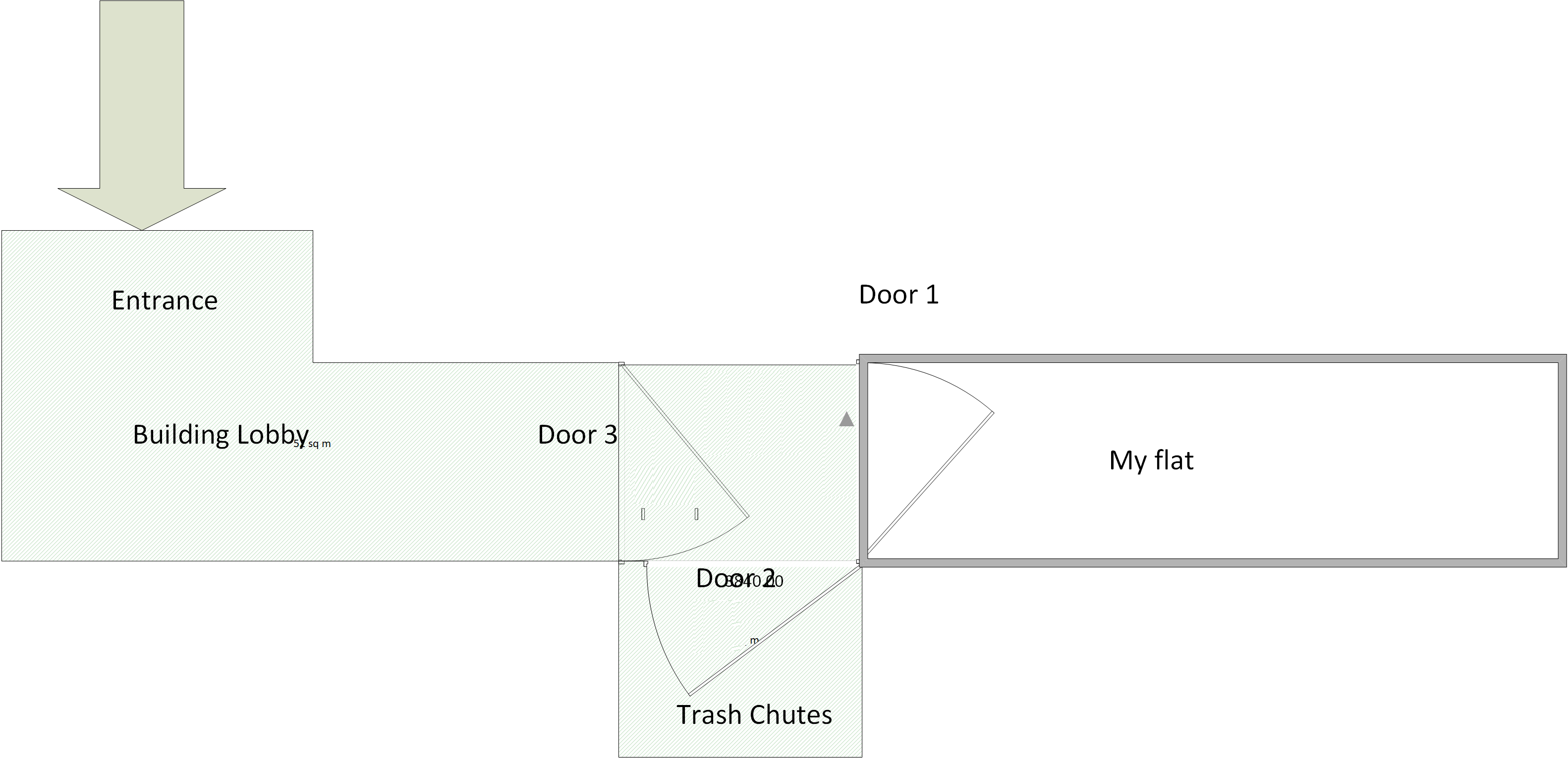

ART Posted March 13, 2024 Report Posted March 13, 2024 Hi, I live on the ground floor and have a question regarding the door inspection in my building, specifically concerning my situation. Adjacent to the entrance of my flat is a very small area (see attached figure). This area allows the neighbor to access the trash chutes near my entrance. All the doors in our building are fire doors. After the last inspection, additional work was performed on doors 2 and 3 to reduce their gaps to comply with the 4mm limit. My question is: Should the gap on door 1 (the entrance to my flat) also be adjusted to be fire compliant, as it has gaps larger than the mandatory 3-4mm? I would assume doors 2 and 3 are meant to protect the lobby, right? Additionally, I am concerned that due to the pressure differences in this small area, it will become very inconvenient to open and close the doors. Even without adjusting the gaps in door 1, since the adjustments were made to doors 3 and 2, it has become common for either door 3 or 2 not to close completely unless pushed firmly." Thank you for your answer and help. Regards, A. TR Quote

ART Posted March 14, 2024 Author Report Posted March 14, 2024 Hi AnthonyB, Thank you for your quick answer that confirmed my concern with non shutting doors (based on simple logic and reading online). So the building has 7 floors, with around 3 flats per floor (the ground floor has only 2 flats) And yes the staircase are at the right of the door 3 when leaving my flat and there is also an elevator in front of the entrance. So is remediation of my door then mandatory if both door 2 and 3 already protecting the communal area from any fire from the flat ? as i see the having both door 1 and door 3/2 protection redundant no ? to give a better idea of the very small area that is between the door (which make the complete shutting of doors difficult due to pressure) Quote
