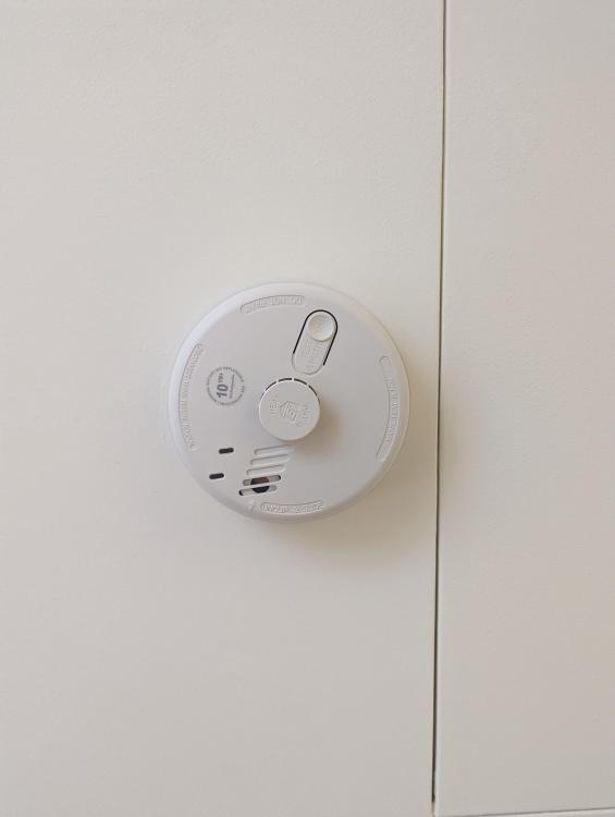

I am looking to troubleshoot my smoke alarms.
I have a hardwired system of
4x AICO Ei161rc
1x AICO Ei164rc
All 5 alarms are beeping erratically and no LED is showing -> thought the wiring was off, as the expiry is dated Jul 2027.

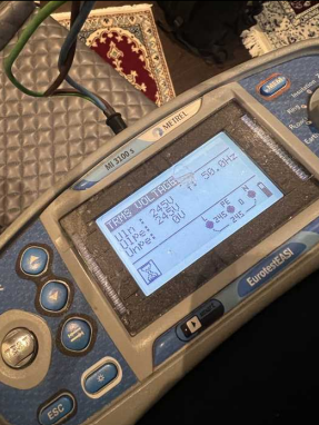

I had an electrician come over and check for a fault, but there seems to be power going to the alarms, see attached picture. Based on what my tenants (since moved out) have said they failed over time
when pushing the test button all 5 alarms sound.
Could it be that the alarms simply hit their end of life due to dust overloading and need replacing?
Looking at the Ei3014 and Ei3016 for that.
Thanks for your help already.
To have 5 smoke alarms have no mains indicator light showing does not sound correct. (I would suspect a wiring problem) With no mains the detectors will run on battery power, but when the battery starts to run low, the detectors will beep every 60 seconds, which is what you appear to be having.
I should also point out that the Ei161rc is obsolete. But I would still get each base checked for mains voltage.

I would guess the electrician who said the smoke alarms were live is not familiar with the operation of interlinked smoke alarms and only checked to see if he could find 240v. I would suspect a broken neutral wire, which would be cheaper to trace than buying all new detectors. Personally I would want to know why there is no supply, even if I was going to change all the smoke alarms
