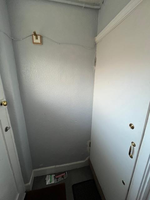

Because there is a very small "communual area" entrance hall (1.5m x 1m) and a shared front door, both flats need to have fire doors. Both flats do already have rated fire doors. The ground floor flat has a door that opens inwards with an automatic closer.

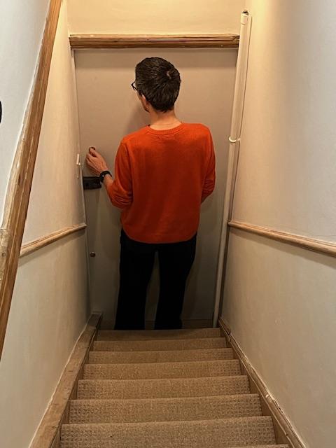

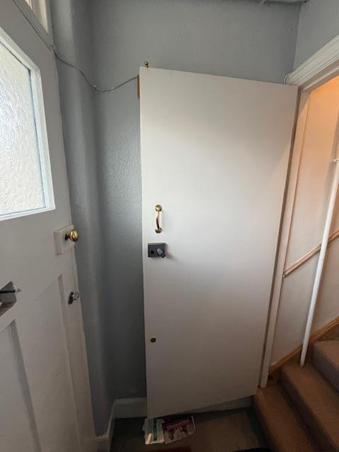

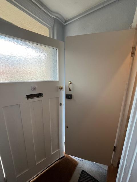

My flat is the first floor flat, where the door to the flat opens directly onto a staircase, and so this door opens outwards. This, to me, poses an issue for my door having an automatic closer. There cannot be one on the inside as it would pose an injury hazard - coming down the stairs to exit the door, your head is positioned exactly where a closer would need to go. On the outside of the door however, my door needs to swing out pretty much completely open for the front building door to be free to swing open the other way. There is no gap between the door frame and the wall. As such, it looks likely to me that even the slimmest models of automatic closer could interfere with or slow down my exit of the building in an emergency.

The s/c device is to shut your door if you run out from a fire in your flat, and stop the fire and smoke spreading into your neighbour's escape route. There are "perco" type s/c devices which go at the edge like the hinges do. , but they are difficult to adjust. Generally the fire service aren't keen on them because they rarely pull the door back into the frame, unless they have been properly set up, and they are difficult to adjust and landlords often can't be bothered to keep going back to adjust them. If you are an owner occupier then the FRA may be able to argue they are suitable if you are deemed responsible enough to ensure they work. One reason the overhead ones are preferred is because they are easier to adjust.
Ps. Your door only has two hinges, should have three (one and a half pairs). You've probably had them inspected by now though.
