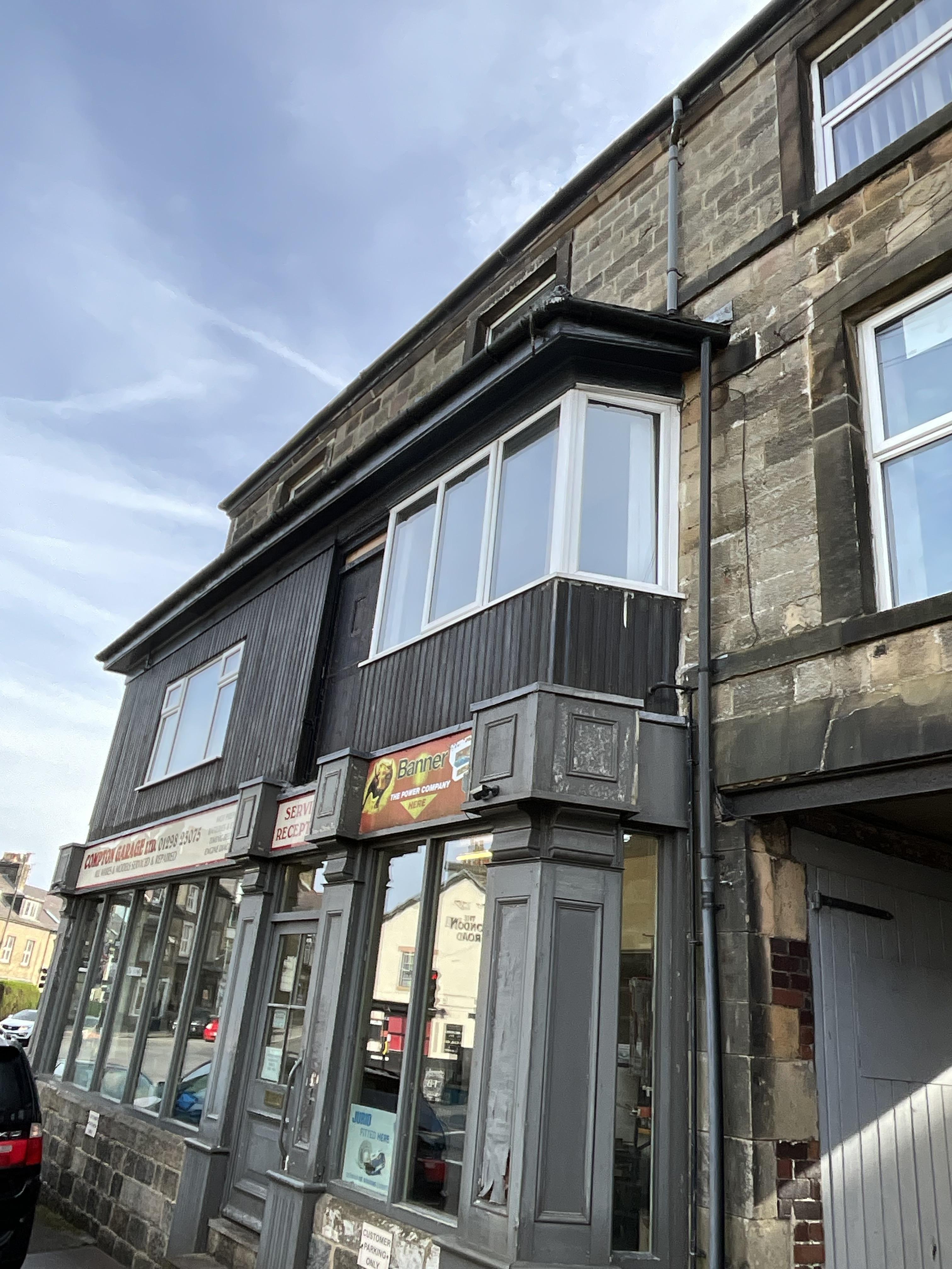

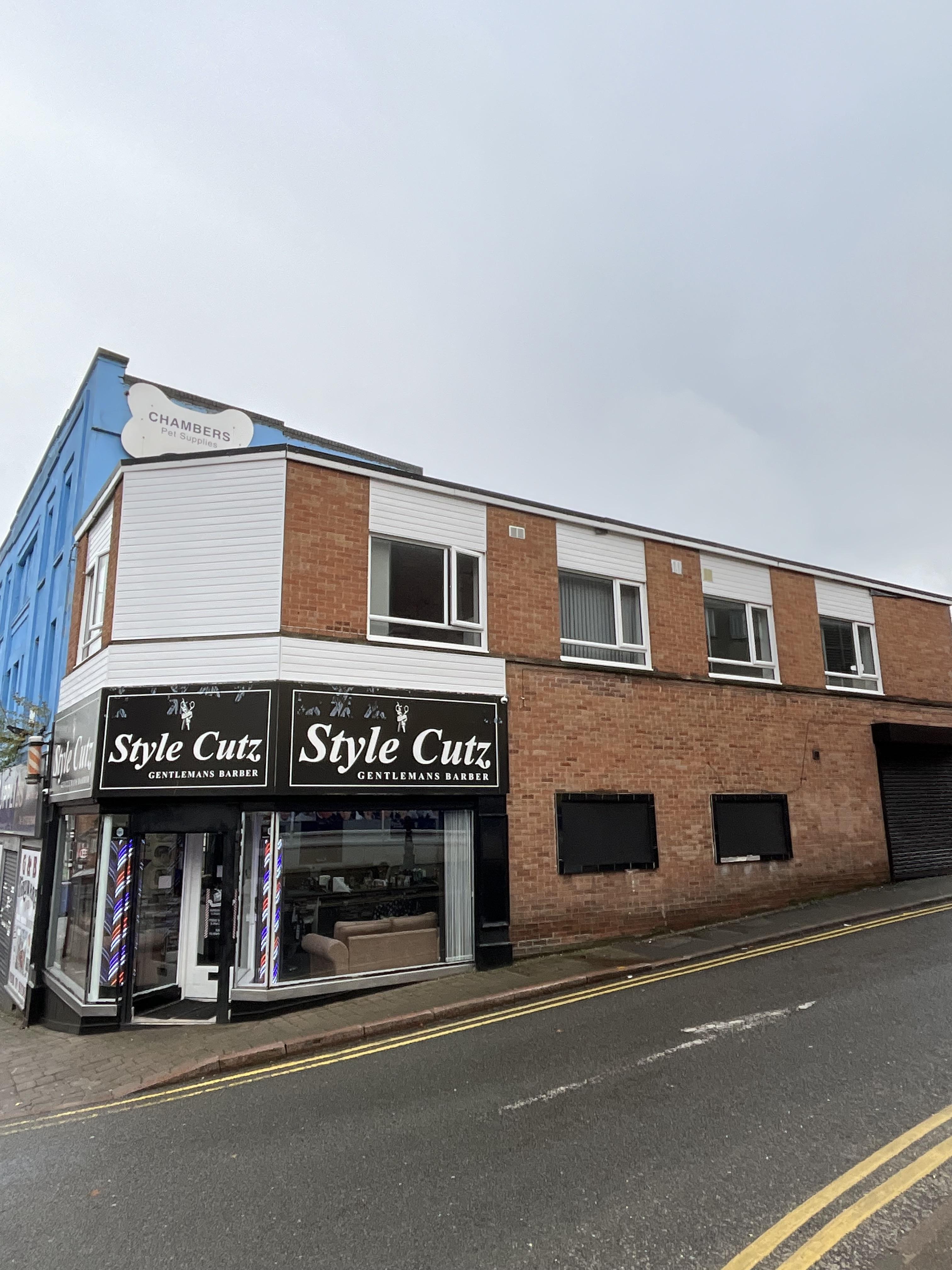

A question for fire risk assessors. Both of these properties have two or more residences. The external walls are masonry but there is some decorative cladding. How concerned should I be in light of the requirements for external wall consideration in the fire risk assessment.

External walls, including balconies and windows etc are explicitly required to be assessed for fire risk in all premises with 2 or more dwellings - however this risk assessment is likely to find most low rise blocks low risk partly because the building standards for these hasn't required high standards of fire performance and still doesn't so it would be wrong to require a higher standard than even a new build requires!
