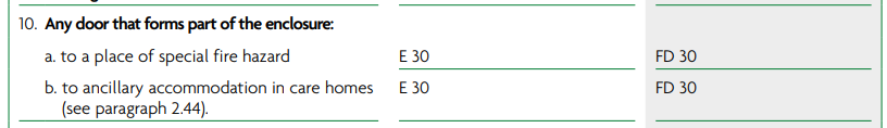

Mike North Posted August 18, 2023 Report Posted August 18, 2023 I am looking at a large dining facility with a large kitchen included. The kitchen is separated from the eating and service area by block-work walls. All frying has its own Ansul suppression facilities. At the moment there is a difference of opinion as to the rating if the fire doors. 1. The kitchen is ancillary and therefore should be separated from the dining area as a compartment and have 60-minute doors, complies with ADB. 2. BS 9999, Table 29, allows for separation of a dining area from the associated from a kitchen by 30-minute wall with 30 min doors. The question is which one is right and why Quote
Neil Ashdown MAFDI Posted August 19, 2023 Report Posted August 19, 2023 ADB Annex C Fire Doors states: But clearly the most recent fire risk assessment should provide details of the fire rating required given the specific risk to life safety, the fire strategy and access for fire fighters. Quote
Mike North Posted August 19, 2023 Author Report Posted August 19, 2023 Unfortunately, I have 6 buildings built to the same design, 2 (the first and last) have FD30S the others have FD60S in the same positions, so the strategy is of no help. The designers have ceased trading, so they won’t help, and the buildings were constructed by Carillion so not help there. The FRA is not concerned about strategy of the building as long as there is one in place, and who would spot the doors are a different rating without reviewing them side by side. Neil, I cannot use a place of special fire hazard (kitchen is not in the definition) , or ancillary because of the size approx. 30% Quote

Mike North Posted August 21, 2023 Author Report Posted August 21, 2023 I think that the question is are the 30 minute doors complaint in the location, if they are not then that also calls into question the serving shutters Quote
Neil Ashdown MAFDI Posted August 21, 2023 Report Posted August 21, 2023 Yes indeed Mike, and compliant with what? Quote
