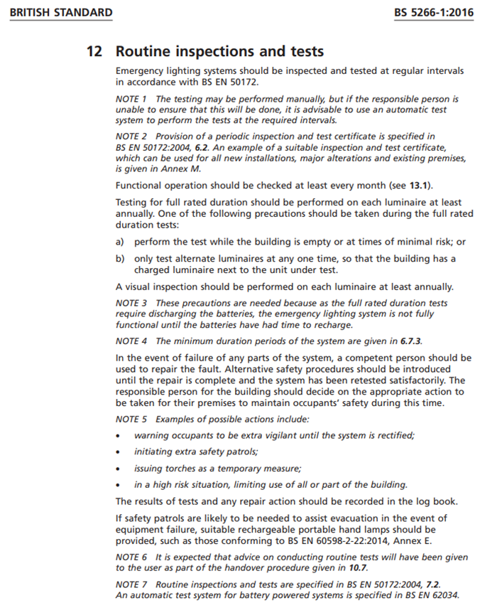

bob2813 Posted August 7, 2023 Author Report Posted August 7, 2023 Thank you for that extract. My Lacors Guidance (which I believe is current), s32.8 references BS 5266-8: 2004 (BS EN 50172: 2004) Emergency Escape Lighting Systems, however I understand that is the guidance I should follow, unless an amendment is made and published for the Lacors Guidance to cover updated documents. So I see no 6 month 1 hour test mentioned. I am currently following the Lacors/BS5266 maintenance guidance, so can't see and of my procedures are missing anything. I will have to go back and ask my competent person where he is getting his information from. What he is suggesting makes sense - the extra test can't be a bad thing, but unless its guidance I should legally follow, then it shouldn't apply, and neither should I follow it, do I interpret the situation correctly. Quote

AnthonyB Posted August 9, 2023 Report Posted August 9, 2023 Because it dated back to old battery technology (such as when wet lead acid central battery systems were common) and gives no benefit. Current battery types are actually damaged by part duration testing and it was found that by hour testing cells soon developed a memory effect and would prematurely fail 3 hour tests - a nice earner for test and install company's but a unnecessary large cost to end users Quote
