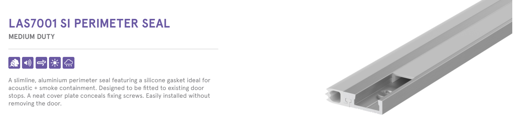

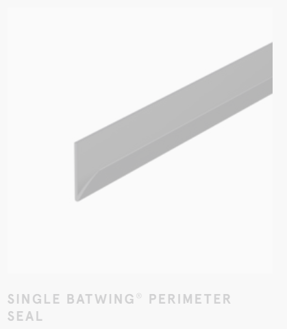

Neil Ashdown MAFDI Posted July 31, 2023 Report Posted July 31, 2023 There are better ideas: For FD30 doors the intumescent seal may be interrupted at the hinge positions (3 @ 100mm) and single lock/keep. For FD60 one of the twin the intumescent seals can be located to by-pass hinges due to the extra thickness door leaf. For smoke sealing use a seal that is attached to the door frame rebate stop, therefore continuous without interruption. Quote

Neil Ashdown MAFDI Posted August 3, 2023 Report Posted August 3, 2023 These fit to the door frame rebate stop so that the flexible seal compresses when the door leaf closes against the stop. Quote
