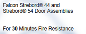

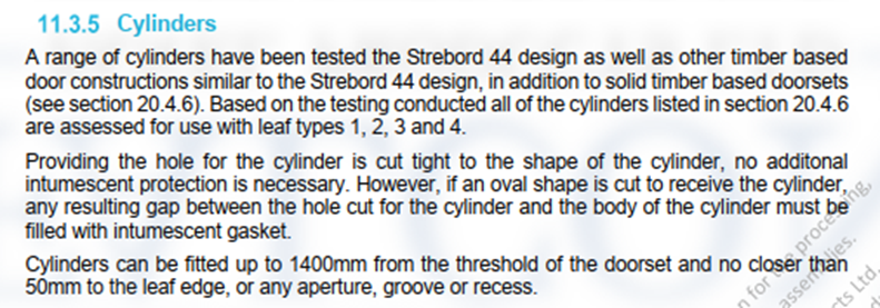

Neil Ashdown MAFDI Posted July 18, 2023 Report Posted July 18, 2023 Hi Mike, Strebord doors with Euro and oval cylinders up to 1400mm up which is good, but as you say it depends on the evidence for the door. But not for cylinder rim night latches, nada. Unfortunately. If you find one please let me know, that would be really useful. Thanks 🙂 Quote

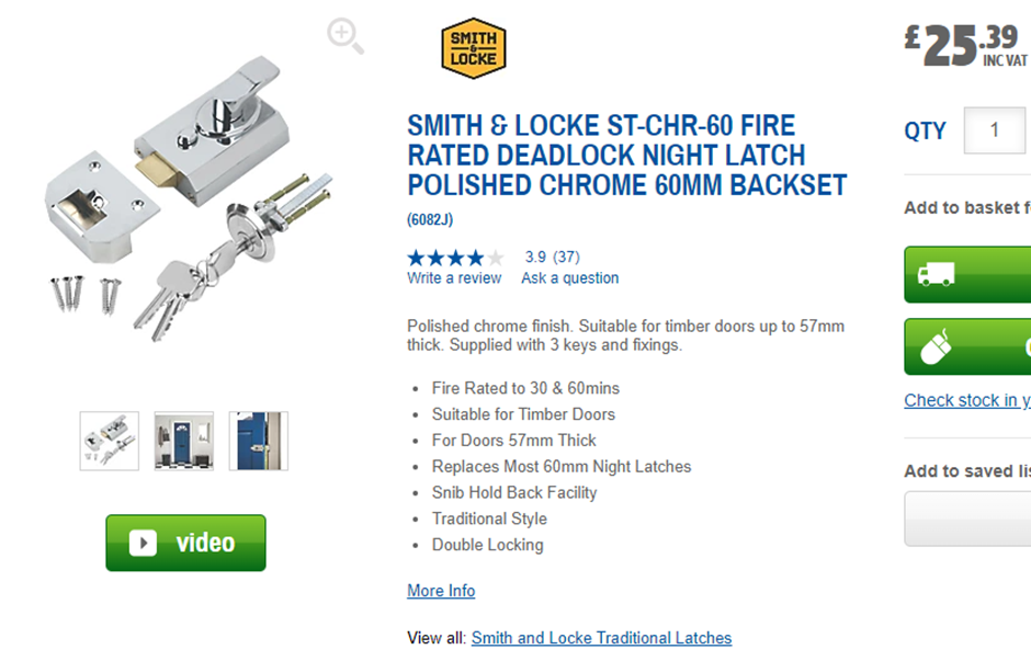

Neil Ashdown MAFDI Posted July 20, 2023 Report Posted July 20, 2023 Thanks Mike, Excellent, we will buy one and let you know how we get on. Quote
Mike North Posted July 21, 2023 Report Posted July 21, 2023 Neil If they become unavailable, I have a major problem since I have approximately 10,000 of them Quote
Neil Ashdown MAFDI Posted July 22, 2023 Report Posted July 22, 2023 To be suitable for a timber-based fire door the night latch needs to be Fire Rated CE / UKCA marked to BSEN12209 and of course compatible with the door leaf in question. Once the one ordered arrives we may be able to check. Good luck. Quote
Neil Ashdown MAFDI Posted September 4, 2023 Report Posted September 4, 2023 No CE / UKCA marks on the product or in the packaging and no specific installation instructions pertaining to fire doors. However, the supplier has provided a Declaration of Performance which references fire resistance testing and use of intumescent material. Quote
Neil Ashdown MAFDI Posted September 5, 2023 Report Posted September 5, 2023 As I said no installation instructions provided specific to a fire door and no BS or EN Construction Products Regulations markings on the product or its packaging. So nothing apparent to be able to link the Declaration of Performance, they provided, to the product. It would, as a minimum, be necessary to obtain and carefully study the 'relevant' fire resistance test report before considering whether (and how) to install. Quote

Patch Posted April 26, 2024 Report Posted April 26, 2024 On 05/09/2023 at 08:52, Neil Ashdown MAFDI said: As I said no installation instructions provided specific to a fire door and no BS or EN Construction Products Regulations markings on the product or its packaging. So nothing apparent to be able to link the Declaration of Performance, they provided, to the product. It would, as a minimum, be necessary to obtain and carefully study the 'relevant' fire resistance test report before considering whether (and how) to install. I found this thread looking for information about exactly this lock. Having bought it from Screwfix specifically because it was listed as 'fire rated', I was surprised to find no standard markings on the product or information in the box. I've gone back to Screwfix and asked them to provide more information about the product and will see if they come up with anything, but I think it'll have to go back as anyone who inspects it will probably find it lacking. I'm aiming to replace another marking-less, non-compliant lock of the same style that was flagged during a recent fire door survey (and which was non-compliant when installed in 2008, frustratingly) but the only other similar lock I can find which looks like it will genuinely be certified is the Banham FD5000 roller bolt night latch, which is over £300 and seems like overkill, but I suppose that'd still be cheaper than totally replacing the door. I think I'll have to do more research on whether the leaf has already been wrecked by the hole for the original lock though. Wildly frustrating that it wasn't done right when it was built and was signed off anyway. Quote
Neil Ashdown MAFDI Posted April 29, 2024 Report Posted April 29, 2024 I am informed that there is no relevant Standard for this type of lock and that therefore CE or UKCA marking is not possible. If you can trace the fire door to its certification or its manufacturer you should be able to check what type of locks are permitted. Quote
