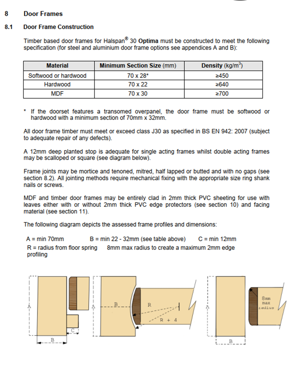

Mike North Posted July 3, 2023 Report Posted July 3, 2023 These dimensions may be of use Halspan FD30 Quote
Neil Ashdown MAFDI Posted July 3, 2023 Report Posted July 3, 2023 So based on Mike's post above (28mm thick door frame jambs for use with a Halspan Optima door leaf) and using a 762mm wide door leaf, the over-all door frame width would need to be 824mm. Check the door frame requirements for the door leaf you intend to install. Quote
George Drayton Posted July 3, 2023 Report Posted July 3, 2023 Red, a)you have a 762x1981 (2"6x6'6") door that is not a fire door, this is a standard size door. B)The existing door frame may be a rebated frame not a planted on door stop and only be for an 1"3/8 door thickness(35mm). C)The existing frame will not have grooves machined in to install fire/smoke seal. D) your opening size between the walls is for a 762mm door +frame. Your joiner makes less sense by suggesting chopping into the wall.without viewing a photo of the opening?. IF he made the opening larger between the walls for a larger door then how would this operate as the components would be restricted from operating with the walls. Or does your exist frame have panelling timber or glass etc at the sides? D) You require a 762x1981 door + the frame /fire door set for your existing opening Upload a photo of the existing if possible Quote
