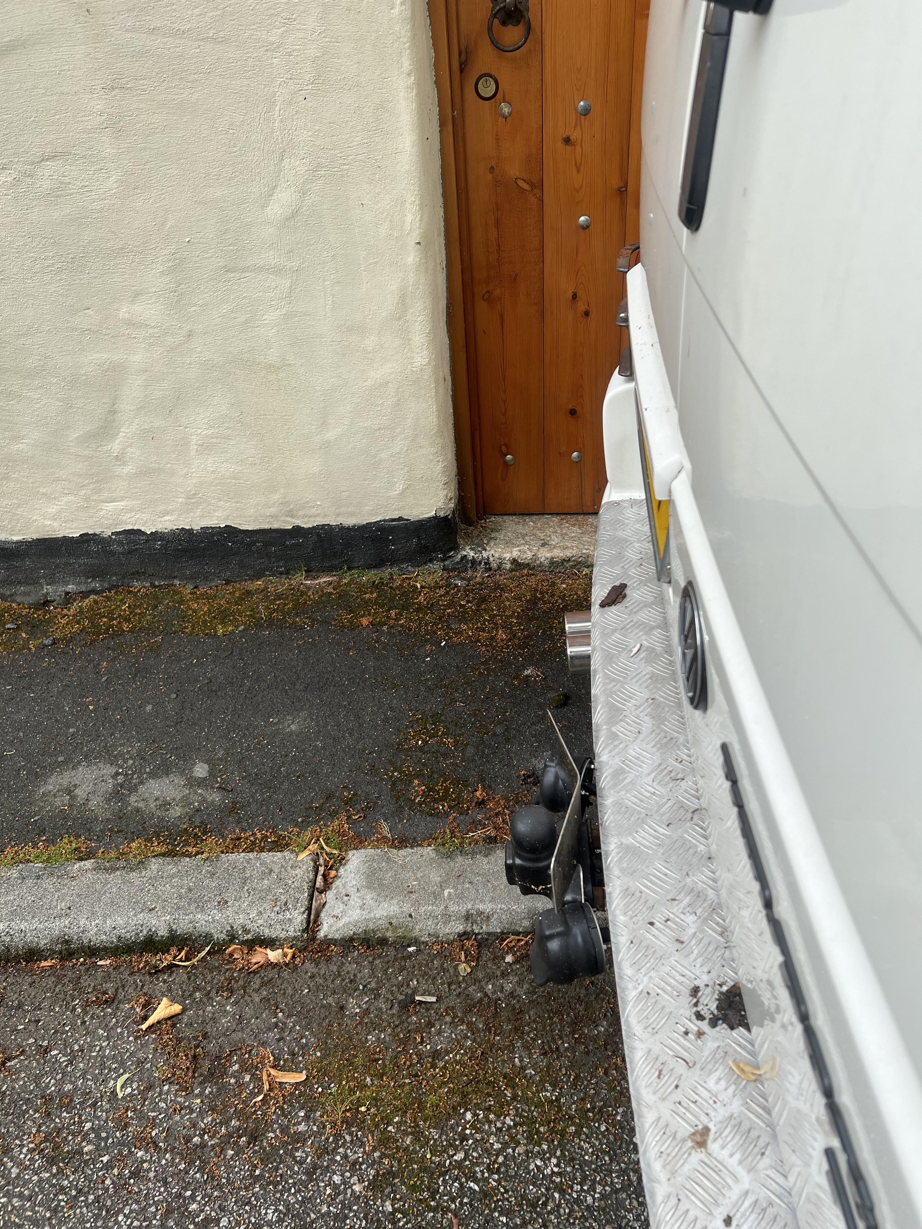

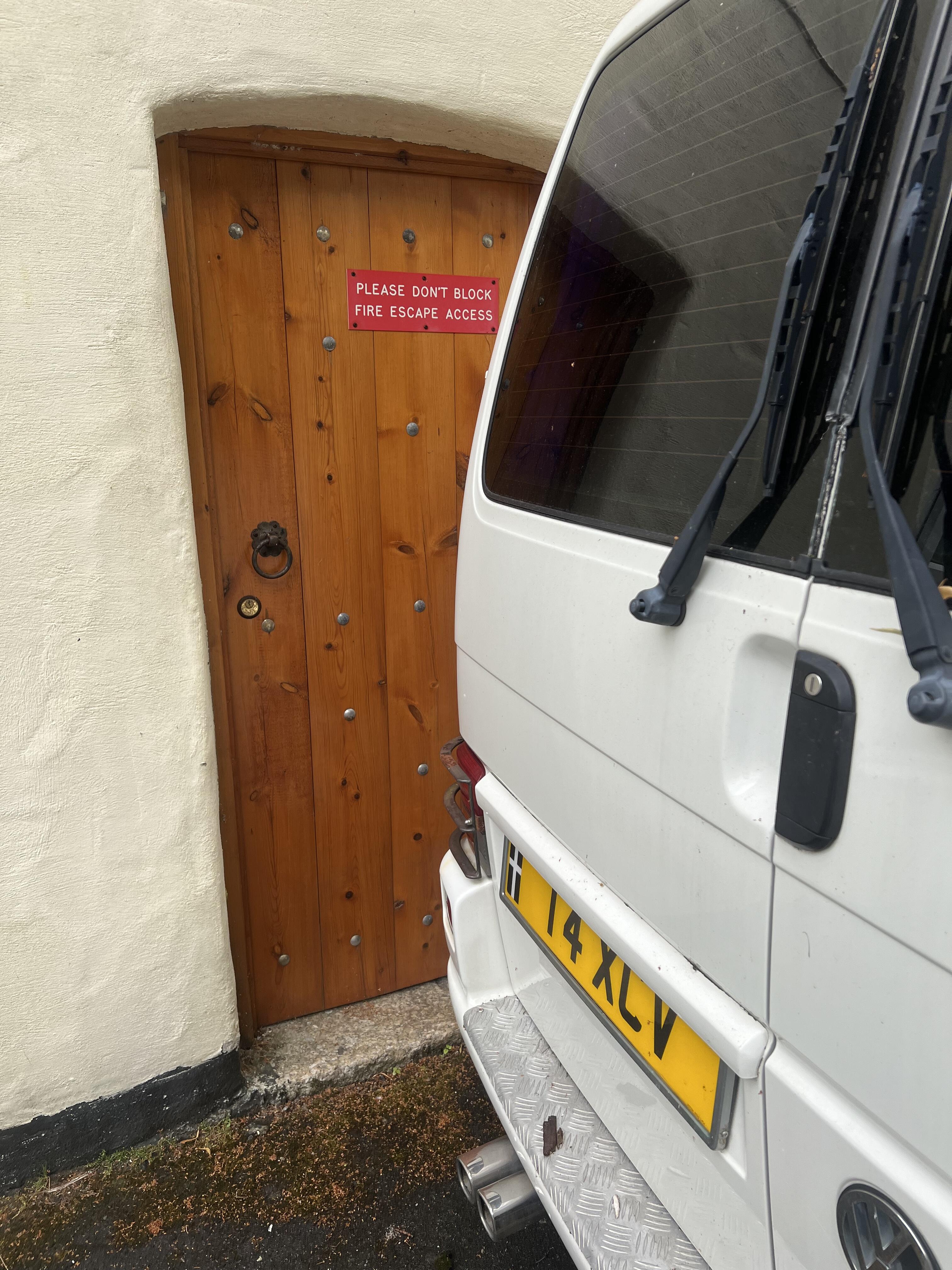

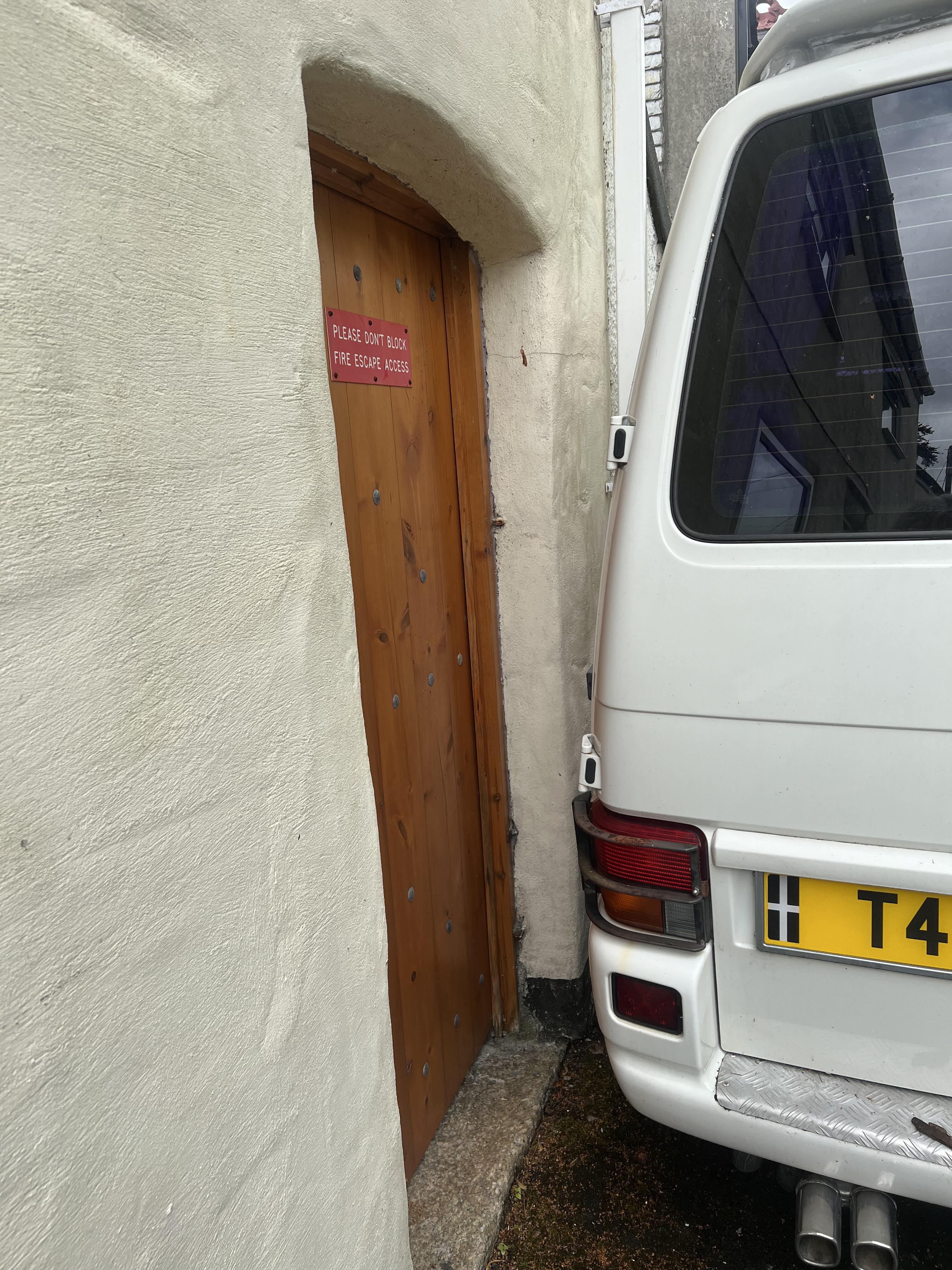

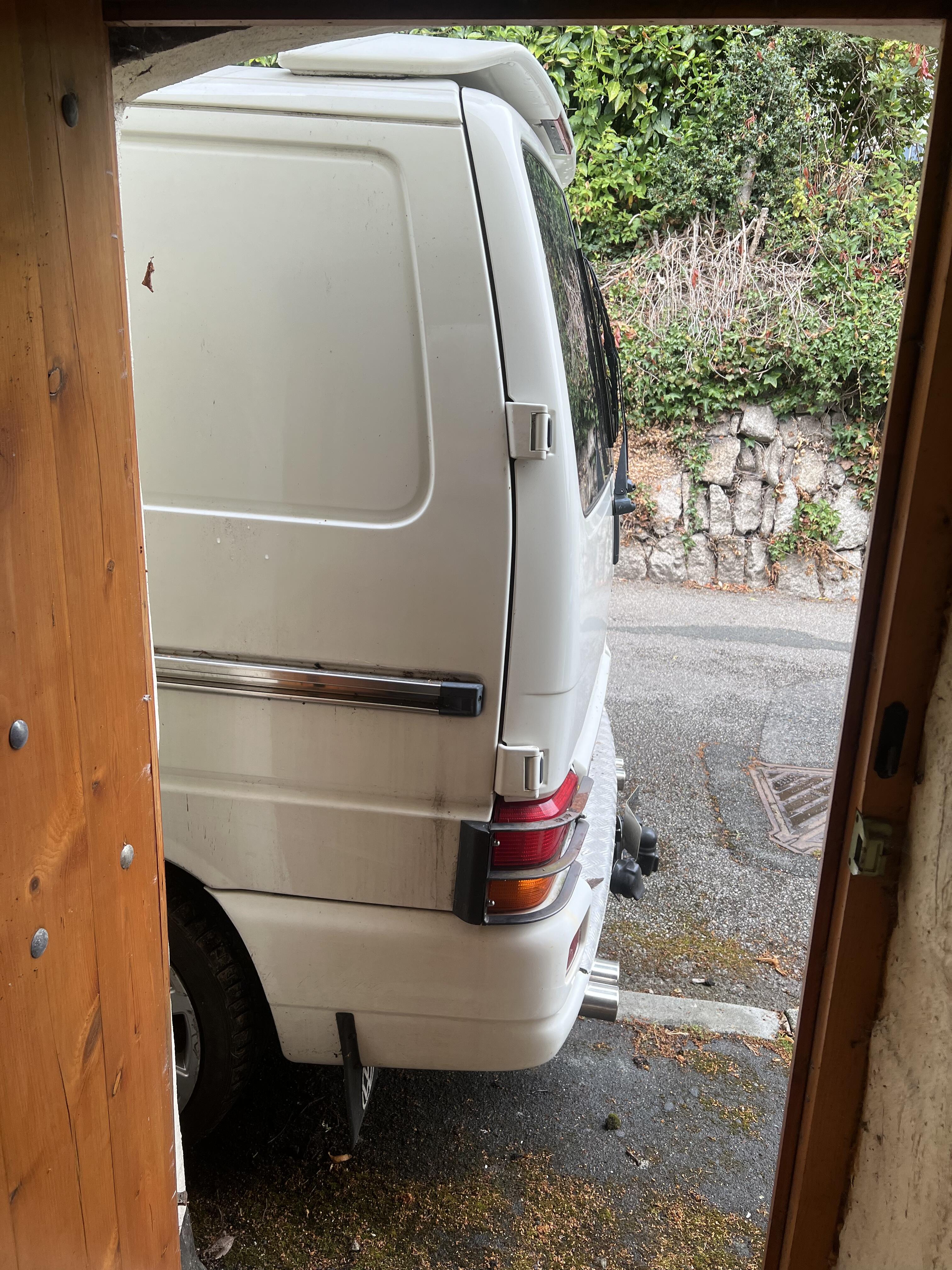

My neighbour persistently parks his van across my residential fire escape. I live in an old cottage with a courtyard and so have no back gate. Apart from my front door, my side gate is the only other way I can escape if there is a fire. It is clearly marked as a fire escape.
the van also prevents me from getting furniture in or out of my house when needed.
This neighbour has provoked and caused me a lot of stress over the years. He parks his van there and doesn’t use it for sometimes up to a year. It’s parked there just to cause a nuisance. He’s done it again today!
I have attached some photos and would appreciate people’s thoughts on this.
