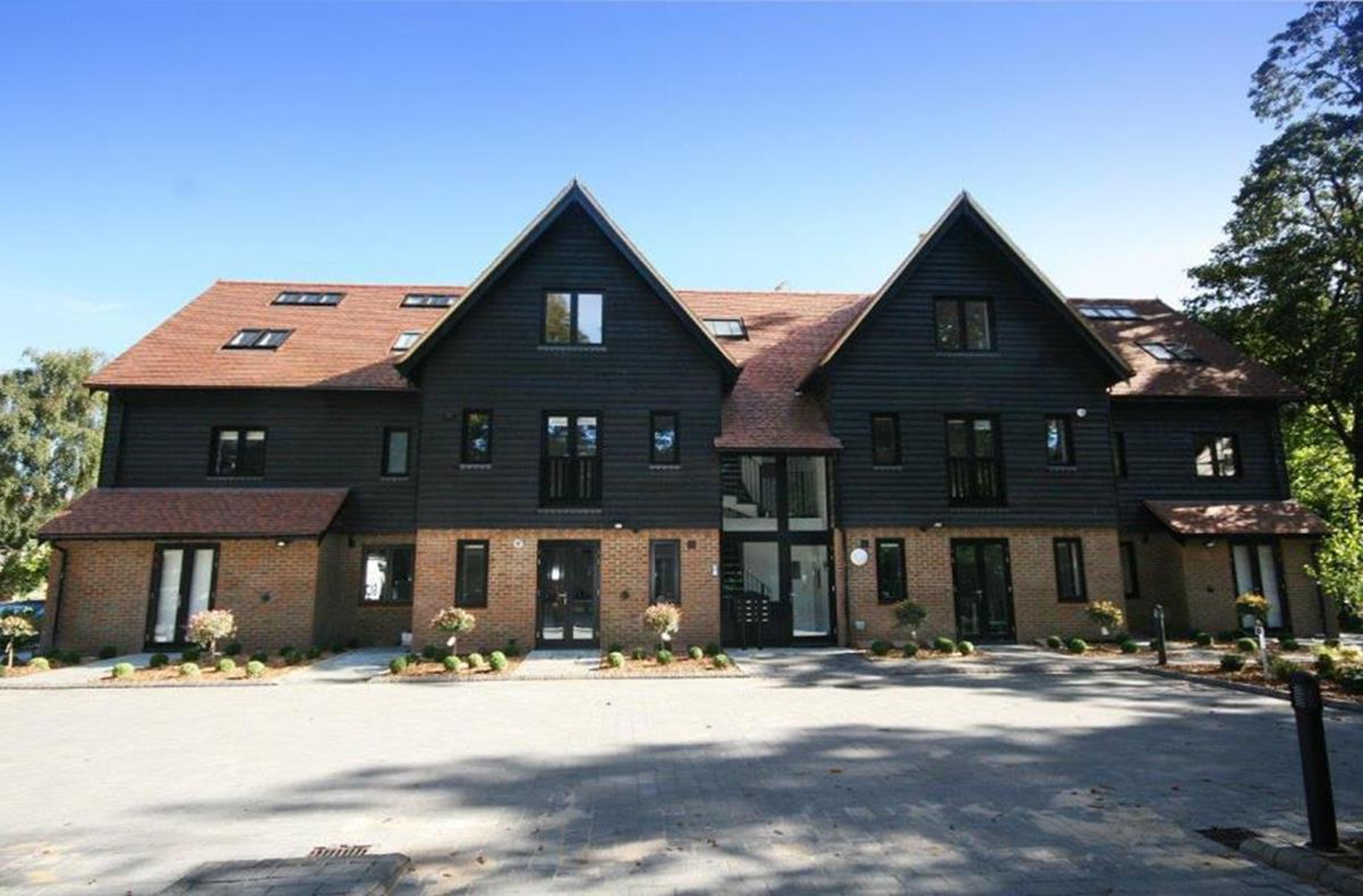

Timber clad converted detached building of 12 self contained flats. Would you suggest a FRAEW in the absence of any in-built, Reg 38 documents?
Premise operates a stay put flats with Grade LD2 non linked between flats and a communal L3. Obviously the current stay put flats could be jeopardised by the potential external fire/smoke spread from the timber fascia.
Thoughts are appreciated as always,image.thumb.jpeg.c042cd035532e4d51609336bbb65e68c.jpeg
