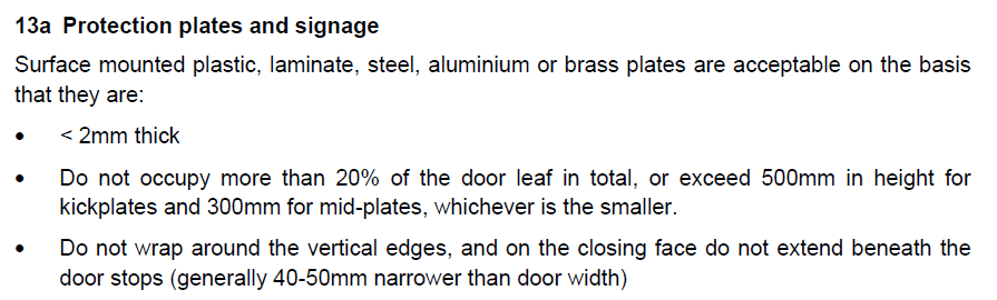

These are dealt with in section 7.3.5 of the document 'Hardware for Fire & Escape Doors: Code of Practice'  http://firecode.org.uk/Code_of_Practice_hardware_for_fire_and_escape_doors.pdf   and typically for a timber-based door the product certification for the door leaf will say, as a general example, something along the lines of:
