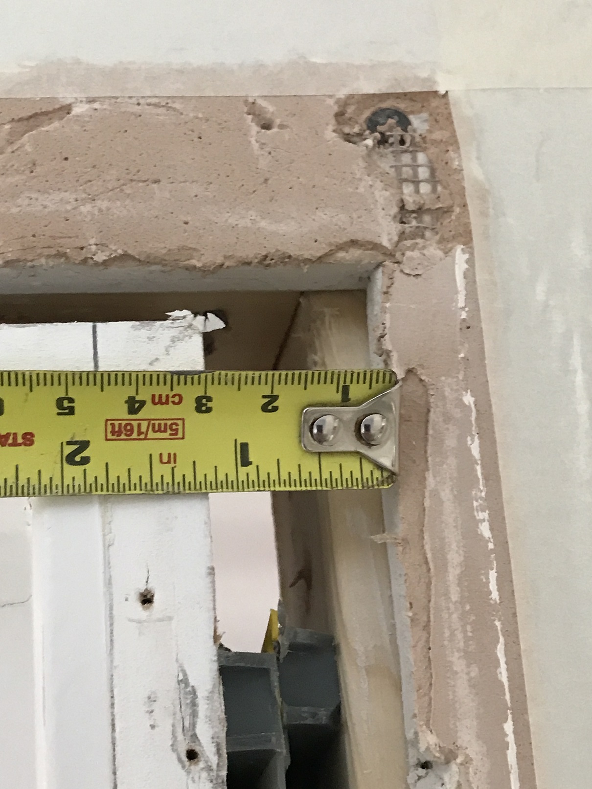

The plasterboards are recessed back from the finished edge of the timber studs on many of the walls, this appears due to the plasterboard having been badly cut at their edges, the recess measuring between 5 and 10mm from the finished edge of the timber stud.

Below is a photo of the door frame and how the plasterboard has been cut back from the timber stud
Yes, this is typical of the different types of non-compliance issues that Fire Door Inspectors see on a daily basis.  Installation of timber-based fire doors should be in accordance with BS 8214: 2016 Timber-based Fire Door Assemblies: Code of Practice and the door manufacturers product data sheet / installation instructions.
