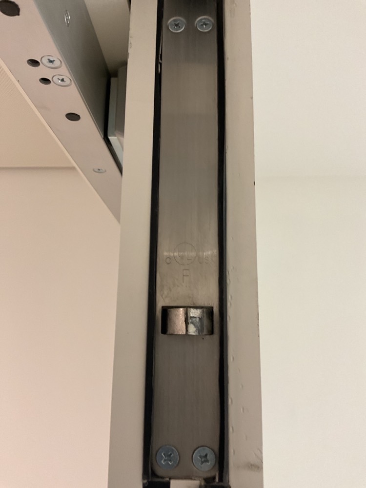

Can anyone identify this lock/latch so I can get some info on it. I want to know if it’s fire rated. It has no CE mark on it. Thanks in advance.22268ECF-6361-40CE-B127-43C75085ABF2.thumb.jpeg.d6949a0ed1126759f99ac1dae8a74025.jpeg
Hi Neil, Yes it’s a fire door an FD60 I believe but lock needs changing but can’t find any details
The lock appears to be located at the top of the closing edge of the fire door and bears no marks indicating its suitable for a fire door?   Usually the evidence of fire resistance performance for a timber fire would state that the lock position should be between 800mm and 1200mm from the door bottom edge. The lock forend dimensions seem quite large too.
There also appears to be a magnetic lock fitted?  If that's so, is it suitable for and compatible with the fire door?
