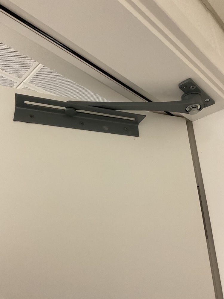

Hi has anyone seen this hold open device before. There is no information on it. D7EC70DF-1316-4BF0-BF47-1D5457BEC870.thumb.jpeg.3683387403d5bef9206b46951e480f46.jpegIt has been installed on a nominal FD30 door. Is it allowed if it’s only surface fitted?
Looks like a hold open device used on the likes of a garage door.
No it should not be used on a fire door,  as it's not linked to your active alarm system, it's manually operated.
