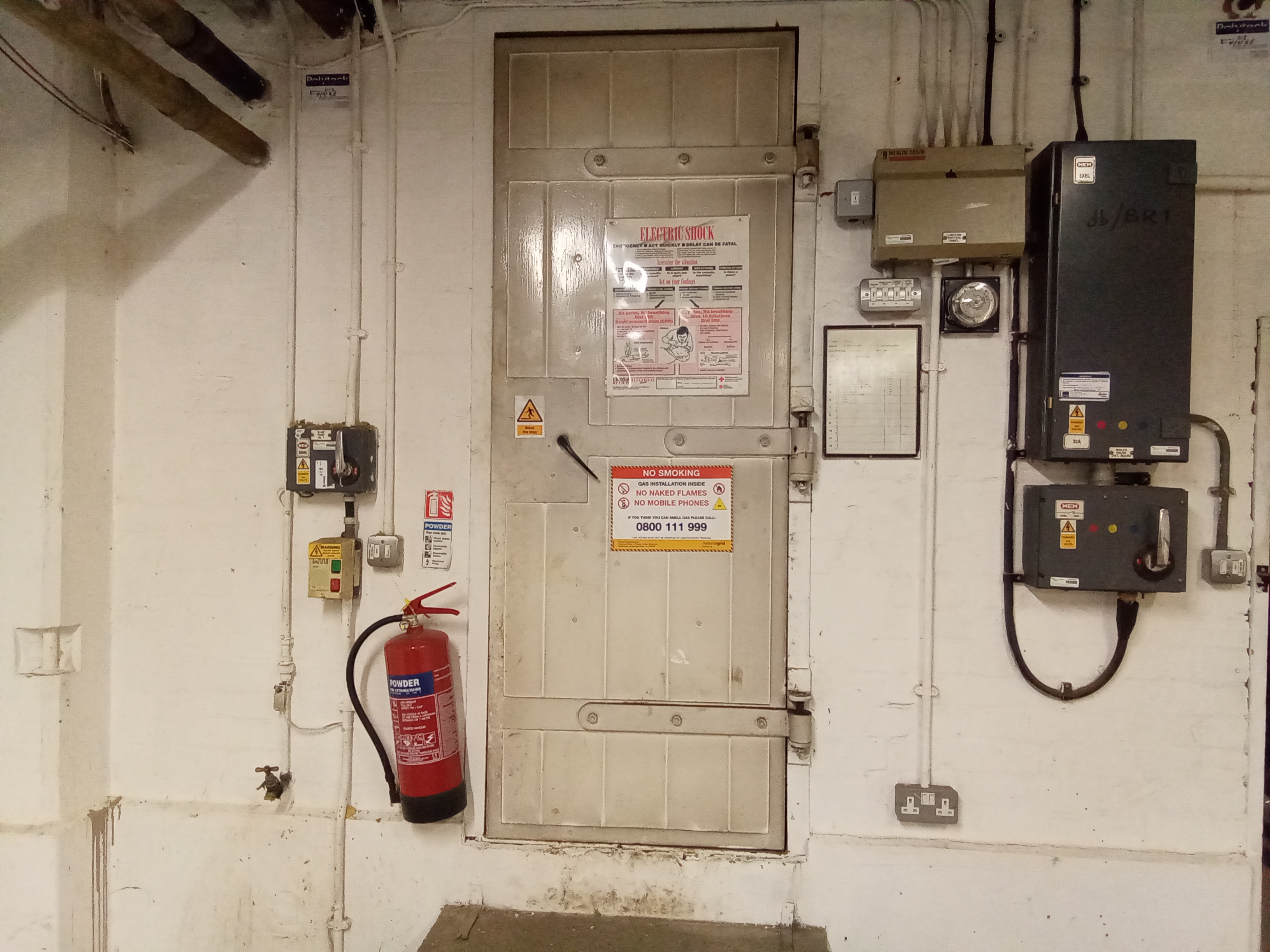

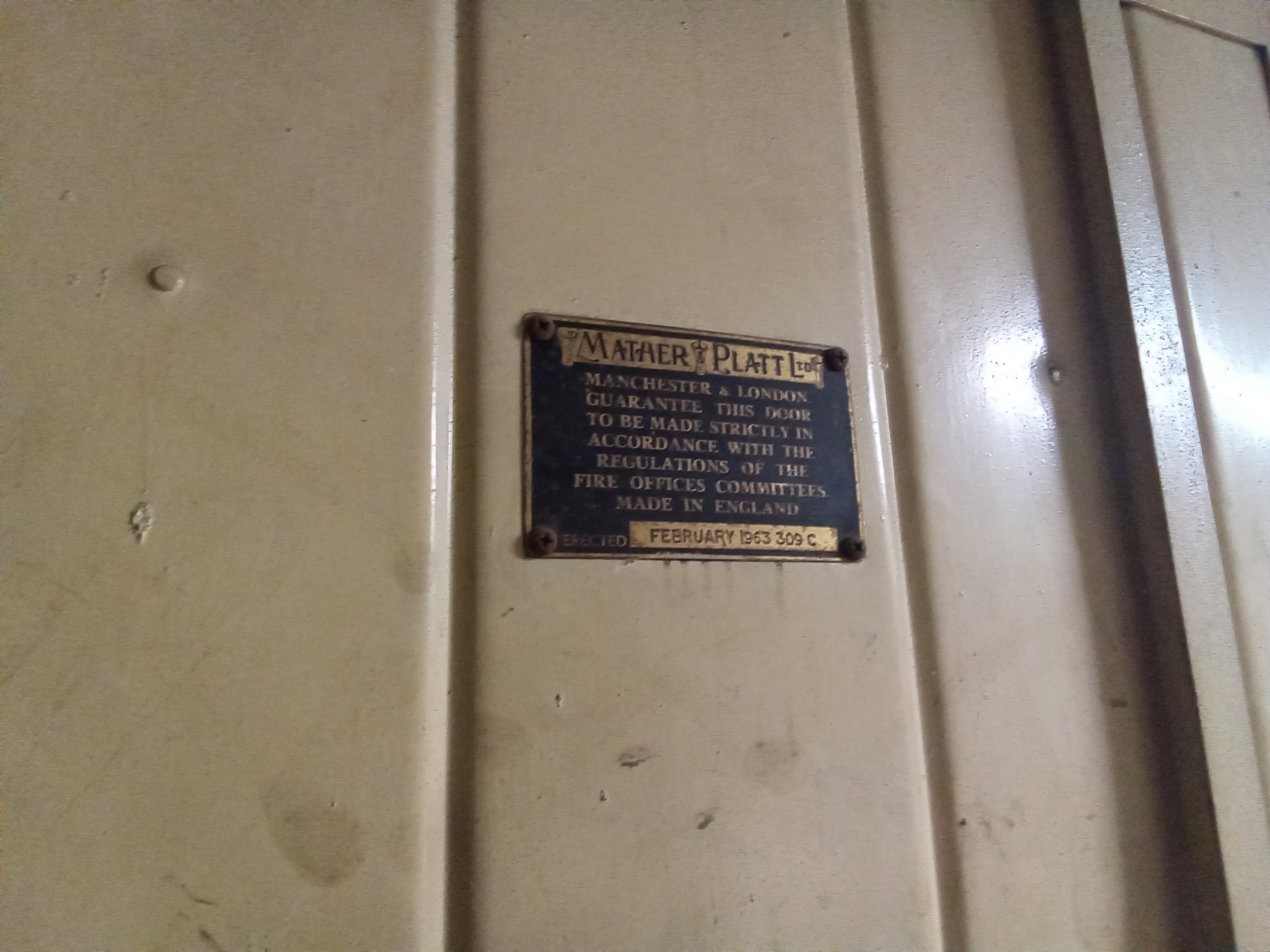

Guest twane-tredoux Posted December 2, 2022 Report Posted December 2, 2022 Hi, I have come across and interesting fire door. Its a vintage steel fire door dated 1963 situated in a plant room that leads to a water tank room. My question is, would this steel door meet todays fire regulations or would this need to be replaced? Thanks Quote
Neil ashdown Posted December 5, 2022 Report Posted December 5, 2022 Todays fire regulations are https://www.legislation.gov.uk/uksi/2005/1541/contents/made Contact DHF for more information about metal fire doors https://www.dhfonline.org.uk/pg/metal-doorsets/346.htm and https://www.dhfonline.org.uk/pg/regular-door-maintenance-requirements/483.htm Quote
Mike North Posted December 5, 2022 Report Posted December 5, 2022 I would be more concerned about the possibility of asbestos Quote
