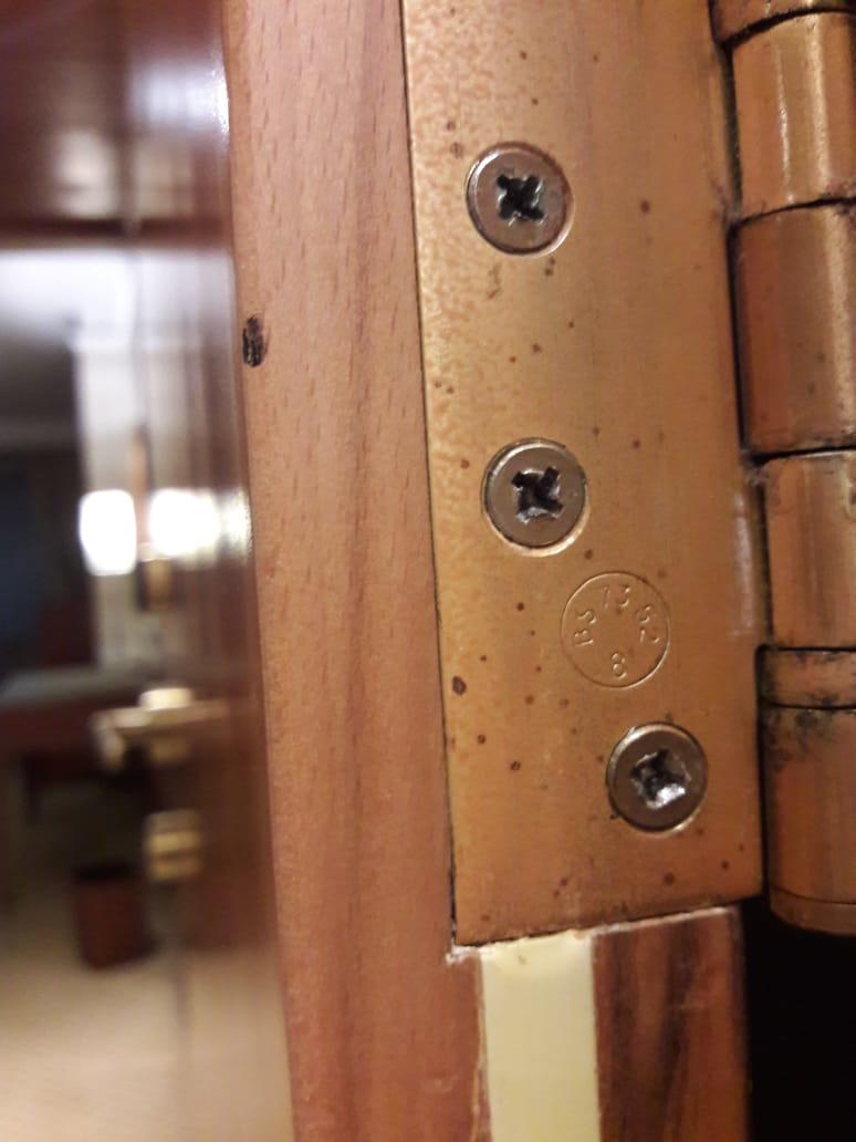

george kawkabany Posted June 30, 2019 Report Posted June 30, 2019 Have a fire door fitted with hinges on which I read BS 72 52 8. Are these hinges approved for fire doors? Quote
Neil Ashdown MAFDI Posted July 4, 2019 Report Posted July 4, 2019 Its actually BS 7352 Grade 8 dating back from the 1990s. In those days, prior to its replacement BS EN 1935 2002, that type of hinge would have been used for Fire Doors. If the hinge is damaged or worn then replace all hinges on that door with their modern equivalent to BS EN 1935 minimum Grade 11 Quote
