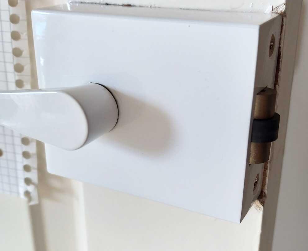

delboy Posted August 22, 2020 Report Posted August 22, 2020 I am leaseholder of a flat in a purpose built black (28 yrs old). FRA done 2 years ago, made no mention of Flat Fire doors to common areas, other than doors met with safety regs. New FRA done this year, now mentions possible entrance door remedial work. Doors are recognised as FD30s. (written in the FRA) All intumescent strips in place. I attach a photos of the roller lock fitted, which I replaced earlier this year, before the FRA. I replaced internal lock with same as was there, which is a Union make. Does this lock look OK for the purpose? Door fitted with original Perko closure, which works perfectly closing the door over the roller lock (great cause I cant lock my self out of the flat) Quote
AnthonyB Posted August 24, 2020 Report Posted August 24, 2020 For an existing premises, yes - simple single action, no key required in direction of escape, can't be latched shut, no snib. Quote
