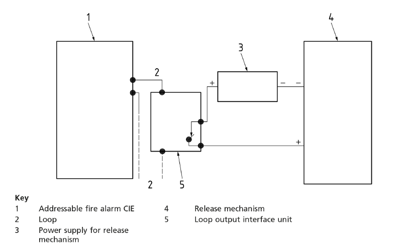

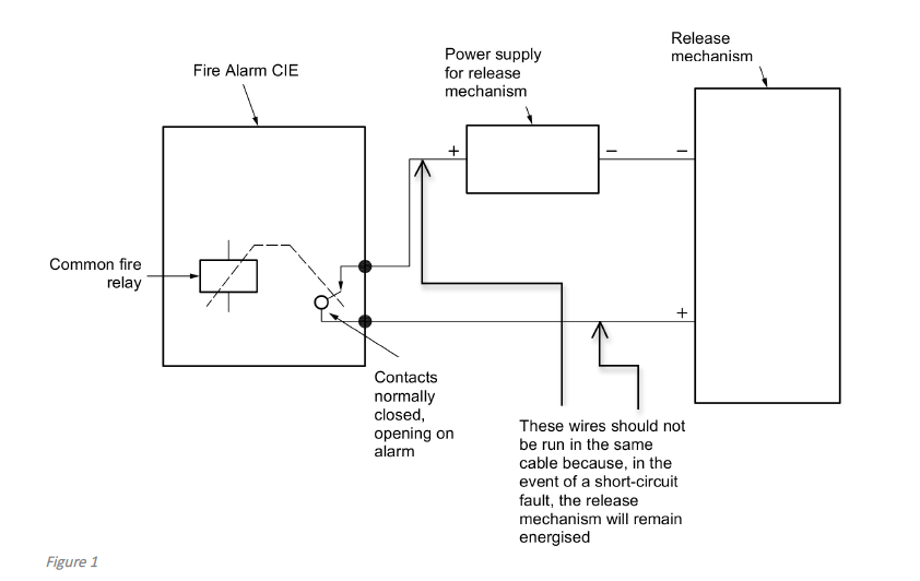

Fire Alarm connections
1 - Conventional system using control panel's relay
2 - Addressable system using i/o unit on the loop (also requires programming on the panel, not just a physical job)
