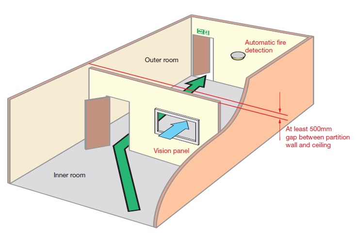

It sounds like you would be creating an inner room situation - the access room should not be an area of high risk (& enforcement officers have in the past treated laundry rooms as such), your travel distances are excessive and you would need one of the below solutions to protect the inner room, so it's not looking advisable
