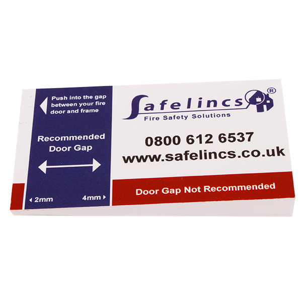

Guest RosalindDav Posted June 26, 2012 Report Posted June 26, 2012 I recently attending a fire risk and safety management course and was advised to obtain a gap gauge with a mirror fixing to be able to check fire doors. I have not been able to find such a unit and wondered if you might be able to advise where this course be purchased? Any information would be appreciated. Many thanks. Roz Quote
Safelincs Posted June 26, 2012 Report Posted June 26, 2012 Hi Roz Safelincs provides these fire door gap testers free of charge. Just email service@safelincs.co.uk Harry Quote
Guest THANK YOU :) Posted July 20, 2017 Report Posted July 20, 2017 Thank you. I have today sent in an Email for 3 of your finest door gap testers!!!! Quote
Safelincs Posted July 21, 2017 Report Posted July 21, 2017 Email received and gap gauges sent :-) Quote
AnthonyB Posted July 21, 2017 Report Posted July 21, 2017 They are different to the BWF ones but still look useful and handy! Quote

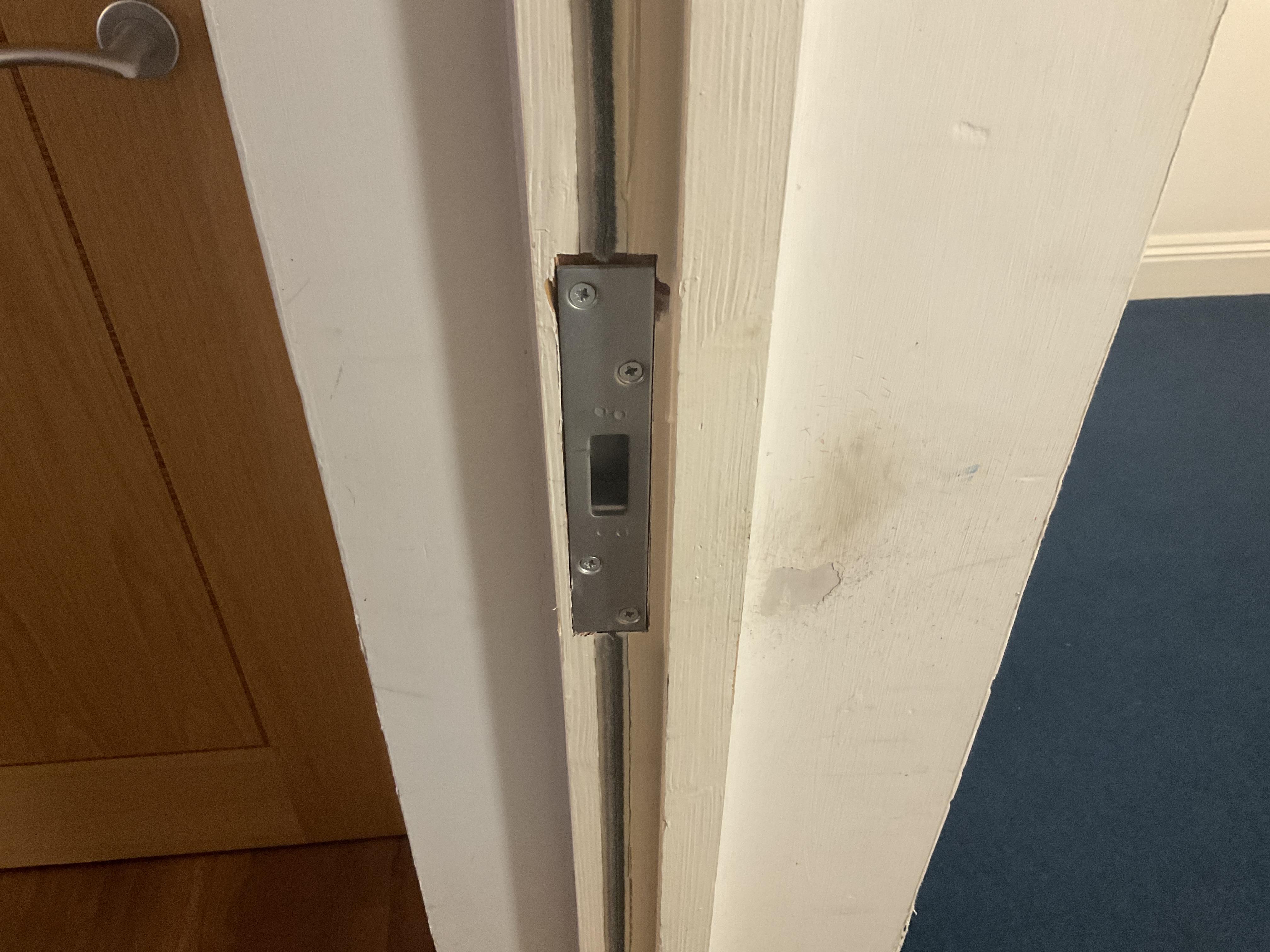

Guest Gap on lock plate Posted January 6 Report Posted January 6 Hello,How do I solve the gap on frame where the lock plate is my fire door has recently failed because there is a gap between intumesant strip and door latch plate measuring 180mm Quote
Neil Ashdown MAFDI Posted January 8 Report Posted January 8 Its OK. The intumescent strip & smoke seal may be interrupted at lock and hinge fixing points. If the inspector/assessor disagrees, ask them to provide specific evidence that the seal must be continuous and uninterrupted. Quote
