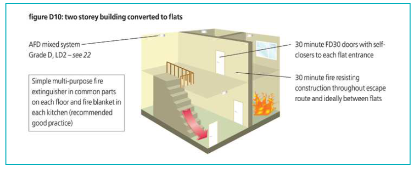

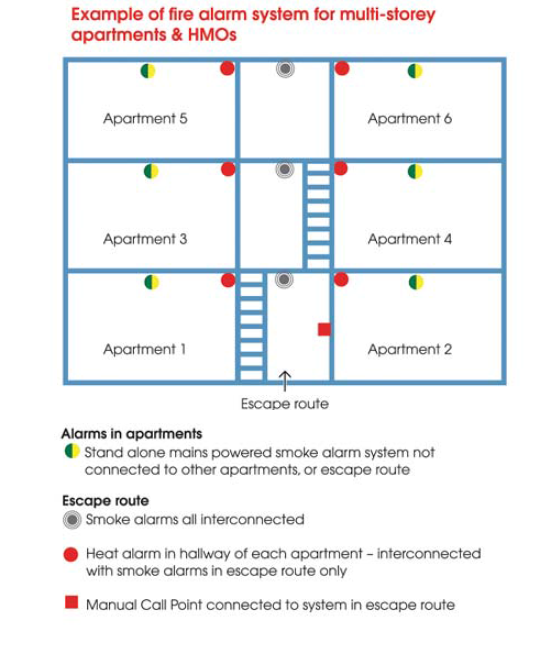

They will be talking about the elements of the communal system required in the building - there should be a common system in addition to the individual smoke alarms to each flat and this common system includes alarms/detectors in each flat
As you are the freeholder responsible for the common areas under the Fire Safety Order and Housing Act you are responsible along with the other owner for the above systems being implemented. If he won't contribute his 50% of the costs it's a civil legal matter between you and him, but if nothing is provided you both risk crimina proceedings under Housing and Fire Safety legislation.
