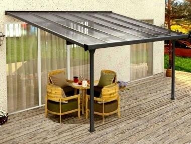

I planned to install a canopy with Aluminium frame and Polycarbonate roof panels to the back of my house. The terraced house is in a new built development so I need to get permission from the management company and the developer Berkeley. Berkeley got back to me that polycarbonate roof which is unacceptable as this is combustible. Therefore you need to consider an alternative product to this, such as glass or a non-combustible material.
I'm surprised by this feedback, as polycarbonate is used widely in the building industry. I googled online, it seems polycarbonate behaves quite well in the event of fire. In terms of combustibility, the wooden fence and wooden shed are more prone to catch and spread the fire. Why the developer can install wooden fence and wooden shed in the back garden but I can't use the polycarbonate panel? It is also in the open space not in the house.
I do not want to use glass panel because A. it is far too expensive, B. glass panel requires 3 posts to support while polycarbnonate panel only needs 2 posts, which is more aesthetic for me.
Can you help me to argue with the developer? Thank you.
