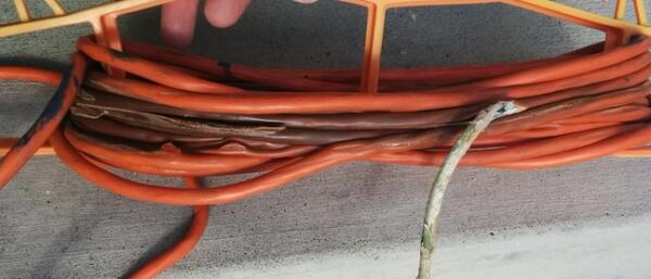

There are a few guidelines when it comes to using extension leads. The cable should be suitably sized for the current it is to carry. (In other words, not too thin) If it is reel mounted it should be fully unwound when using a high load (Anything with  a heating element, kettle, hairdryer, electric heater) if you don't the cable will overheat and cause a fire. (It's a very common problem with extension leads) Never plug an extension lead into another extension lead. Never run an extension lead under a carpet (It will wear out, short circuit and cause a fire) Never use an extension lead near water, and don't leave one outside.
