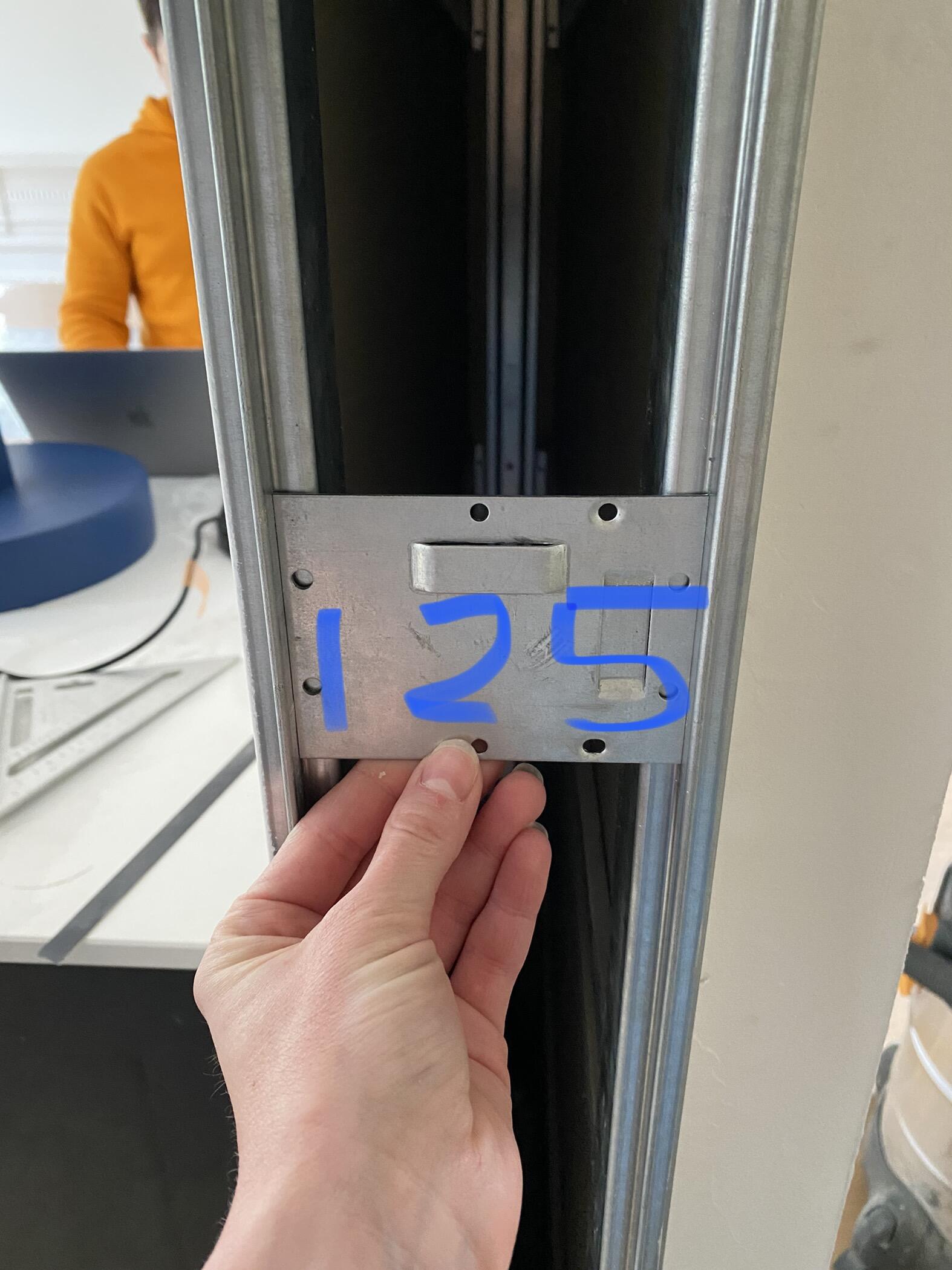

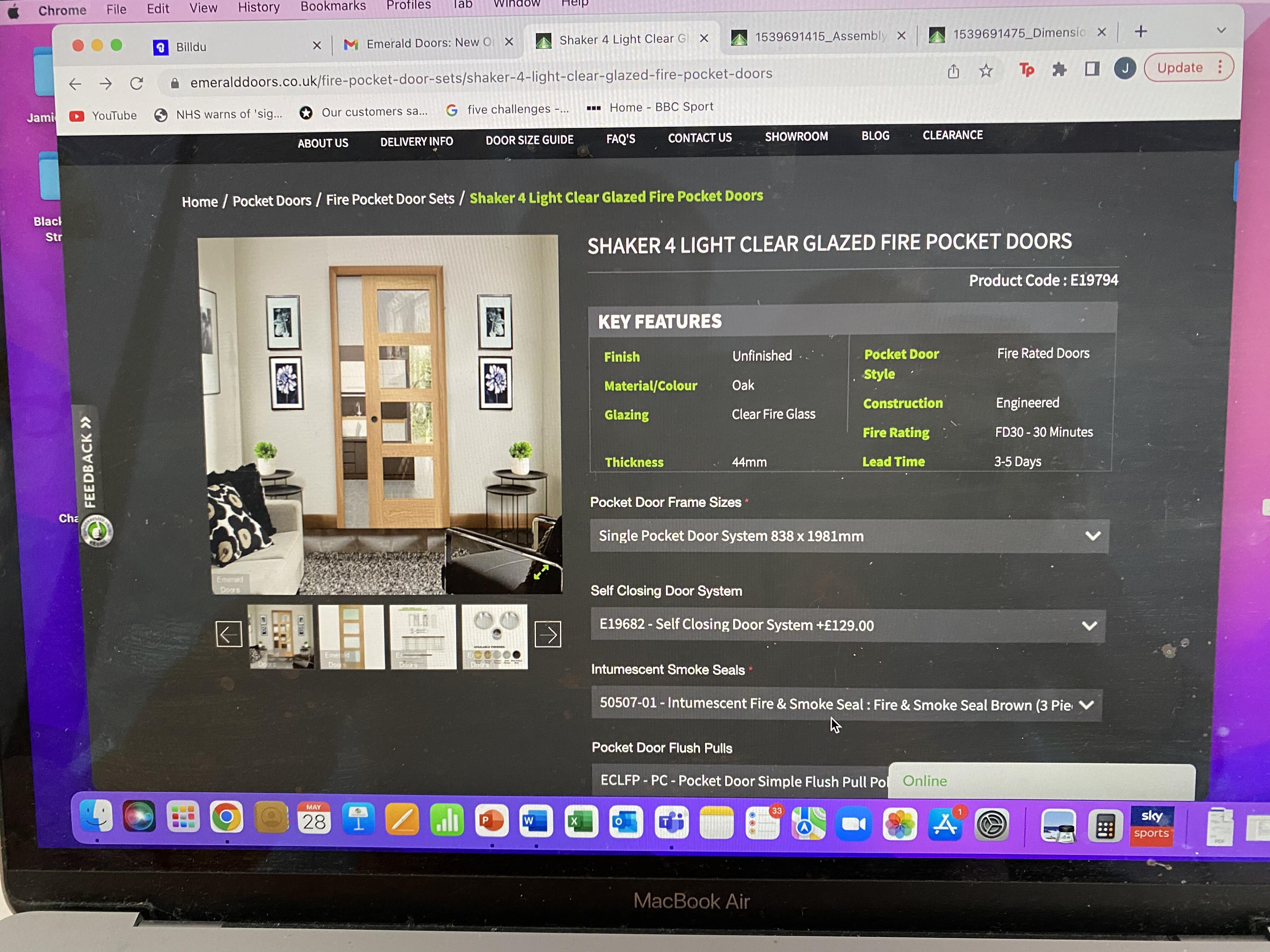

Please can you advice on a fire rated pocket door and it's system. I have recently been going through a rebovation in my home, after a structural engineer advice we have opened up a wall between kitchen and living room and the beams have to be 125 mm thick minimum so we did that. And because we live in a flat we need to change all the doors in the flat to fira rated doors. We have bought a single fire rated door system with jambs from eclisse to fit 125 thick wall as per their description on the website but they have send us a jambs fitting only finished wall 100mm. They refusing a refund claiming that fire regulations only allow fire rated pocket door of 100 mm finished wall thickness. I am really confused and would like some advice please. What are the regulations around fire rated pocket door do they only come in 100 finished wall thickness? Is this regulated I just can't seem to find any information about it. I would appreciate your advice.

The pocket-door system has evidence of fire resistance performance referencing to an IFC Report.  Ask the product supplier for a copy of that report to see how wide the scope is for the product's field of application.
