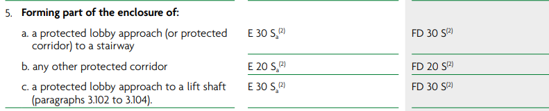

From Approved Document B, Appendix C image.png.d124c0facf89afc50babbd605c2568de.png
https://assets.publishing.service.gov.uk/government/uploads/system/uploads/attachment_data/file/937931/ADB_Vol1_Dwellings_2019_edition_inc_2020_amendments.pdf
So if the fire door to a cupboard opens onto a protected escape corridor or stair, the door should provide for restricted spread of cold smoke eg. FD30(s)
